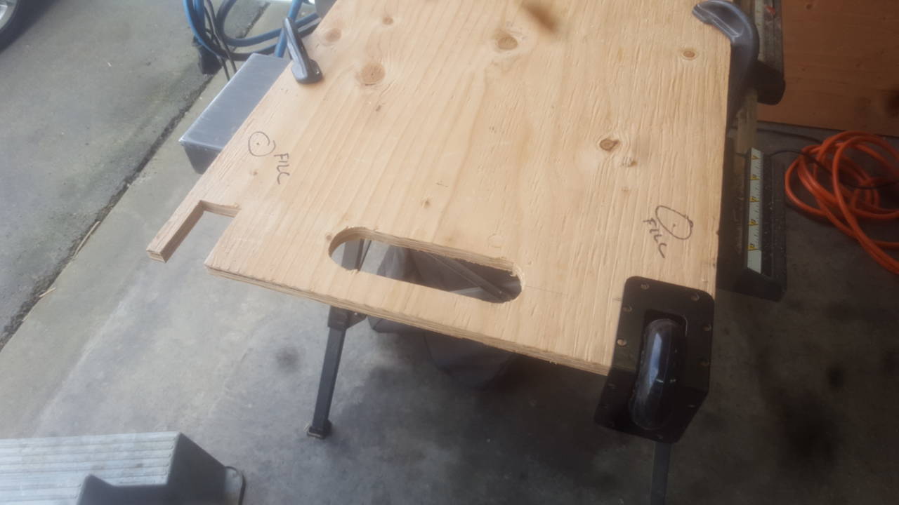

Drilled and cut holes for the hardware in panel 8. The panel is just mocked up in the photo. It's not installed yet.
Cut the hole for the Top Hat Pole Mount. Didn't have a drill bit large enough (1¾"), but luckily the router circle jig went small enough to take care of it.
Bottom view of top hat placement
I decided on putting only one connector in the top.
Drilled holes for connectors in the mouth and ran all the wiring.
This wire is a little clown shoes large for this purpose. Oh well.
