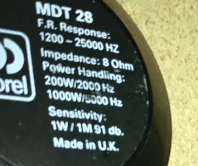

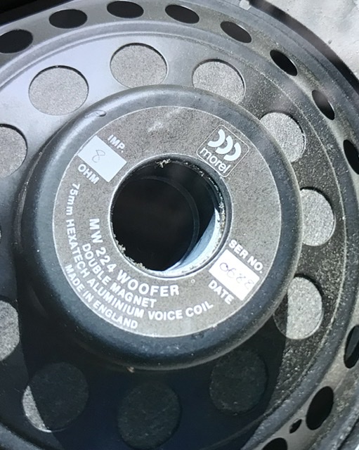

I have a pair of old McIntosh speakers that the cabinets were damaged in a flood. I was wondering if I could use the speakers and xover parts and make some book shelf speakers or any of bills designs.
The Woofers awe morel MW224 and highs are MDT 28’s. I have extra 2 woofers

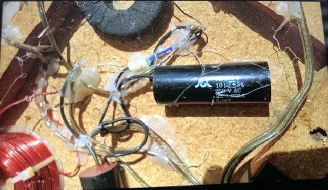

This is the xover in the pic

I found these specs for the woofer at this link https://www.diyaudio.com/forums/swap-me ... nts-2.html
TSP Parameter des Lautsprechers: Morel - MW-224

Can't see much of the cross-over specs except that the one of the caps is 10uf and 250 volts

Unless you have an inductance meter, you have no idea what the inductors values are, so that makes it more difficult to calculate what crossover is installed.

Regarding identifying the value of an air-core inductor, it's not beyond the wit of man.
I might use a resistor of known value and an ocilloscope.
But if you have a micrometer or feeler gauge for wire diamers and can do a little math, you can estimate the value of the inductor by observation and calculation with Wheeler's Approximations.
Look here: http://tesla-institute.com/%21app/sim/acic.php
You can also use the calculator from that website to reverse engineer your coil by plugging in values until everything matches your wire gauge and coil size.
