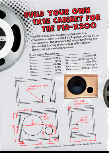

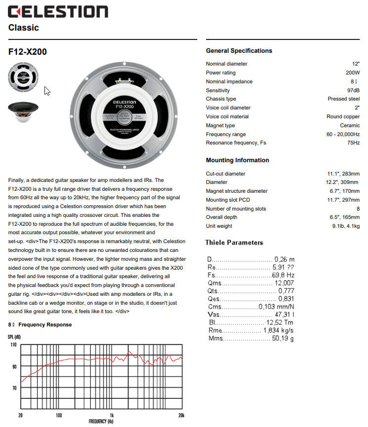

Hi, its been a long while, but I have the Thiele parameters now for the Celestion F12-X200.
I have attached them.
Celestion itself recommends a bass-reflex cabinet and provides a plan here:
https://celestion.com/speakerworld/irs/ ... et_Design/
I have tried the F12-X200 in already this cabinet:
https://www.lean-business.co.uk/eshop/m ... -2957.html
For music it sound great, but any of my guitar presets sounds "boxy", don't know how else to describe.
It's as if the speaker/cabinet is placed in a large box.
So I'm again looking to build something myself, either form the plan from Celestion or from one of the designs from Bill (as I'm quite happy with my XF212).
That could be a simplex or an XF212 with larger dimensions.
Hoping you can make a recommendation based on the Thiele parameters !

- Posts: 29130
Re: Simplex for Guitar FRFR use with Celestion F12-X200
That driver is totally unsuited for a ported cab. Why Celestion recommends it I can't understand. It would work pretty well in a sealed Simplexx Wedge. If it turns out to be boomy totally fill the cab with polyester pillow stuffing.

- Posts: 29130
The Qts of .77 is only appropriate for a sealed or open back cab, not ported. The Simplexx Wedges are optimized for use with Eminence coaxial drivers, which work best in ported enclosures. To make one sealed omit the ports.
