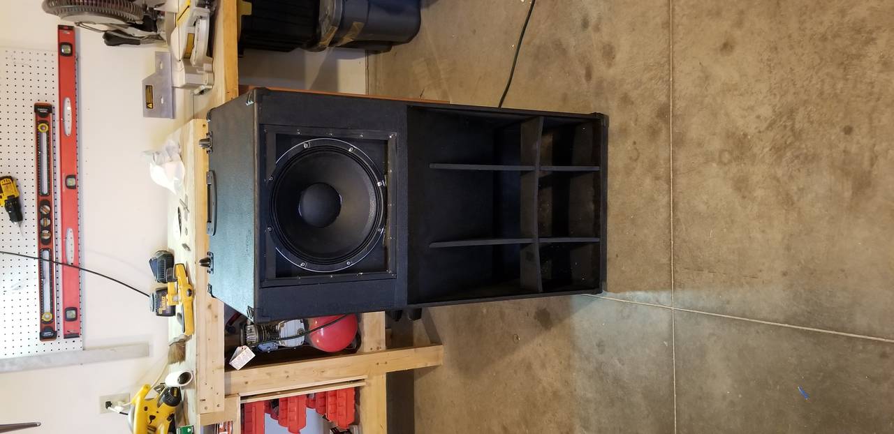

Re: Titan 39 Build
The 3012LF came in today. I gotta say I'm a little impressed with my measuring skills. Lol! I sized the driver holes with the technical spec sheet and it worked out perfect. That driver fits tighter than a gnat's ass. Also, my flub with the panel placement didn't hinder the driver installation. I'm sure it will affect the output since the driver chamber has been slightly reduced, but I'm really not smart enough to do all that math. Next, I'll fit the access cover, seal it, and test.
At any rate, here are a few pics of the driver fitment.

Re: Titan 39 Build
Looking great so far
You don't want to undo that driver, but they shouldn't be a tight fit!
Heat makes metal expand right? If it's got no where to go, it will do something else, like break itself, or the cab.
Also, if needs be, how do you get it out if it's tight?
You can see your pencil line for the driver, make sure you cut out to that line for the rest
Re: Titan 39 Build
I'm also a little worried about how much you trimmed from the upper flange - there is only a tiny bit left to seal with the driver cover at the top of the half-moon. I remember not cuting that at all on my T-39, and I don't see it trimmed in the sketchup model.

Re: Titan 39 Build
I should've been more clear with my redneck slang I guess. Haha. What I meant when I said it fits tighter than a gnat's ass, is it's a perfect fit. There is approximately 1/32" space around the driver to allow for expansion. In the plans it just says to cut it so it is slightly larger than the driver basket. If it needs to be larger than that please let me know. The last thing I want to have is a 50 lb paper weight.Grant Bunter wrote: ↑Thu May 30, 2019 6:07 pm Looking great so far
Thanks for the tips, Grant. I'll be more deliberate in my next builds.
Re: Titan 39 Build
You're right. It doesn't say to trim it in the plans. It says that if the driver won't fit, then install the top horizontal brace with screws and gasket tape in between to seal the joint. I wasn't real comfortable with that seal. And I saw elsewhere on the forum where someone else did a similar technique...I ripped it off from them. Also, I ensured that I have at least 1/2" for my gasket tape.billkatz wrote: ↑Sun Jun 02, 2019 11:43 pm I'm also a little worried about how much you trimmed from the upper flange - there is only a tiny bit left to seal with the driver cover at the top of the half-moon. I remember not cuting that at all on my T-39, and I don't see it trimmed in the sketchup model.
You have cause for concern and it will be a point of attention for me. I'll report back how it works.
I haven't glued it down yet. So if it doesn't work then I'll just replace it with a piece that hasn't been trimmed.
Thanks for looking out.

Re: Titan 39 Build
Ohh cool, that's great then. I thought you meant tight!!!!Bigcox4002001 wrote: ↑Sat Jun 08, 2019 9:59 pm There is approximately 1/32" space around the driver to allow for expansion.

Re: Titan 39 Build
It's been a long summer. Moving, relocating a family member, 6 weeks of 12 hour days and no weekends, exercises, inspections...all the things that come with being a military leader. In the end though, we're all settled and the first Titan 39 is done. Far from perfect, that's for sure. But so was my first Otop 12. The next three will be a much smoother process. I'll have to wait awhile on those since I have three gigantic, ancient Philco radios I have to refurb and a car to get ready to sell. But once all that is over I'll be back on track. Thanks to all that have helped along the way! It's all done save for the grill.
