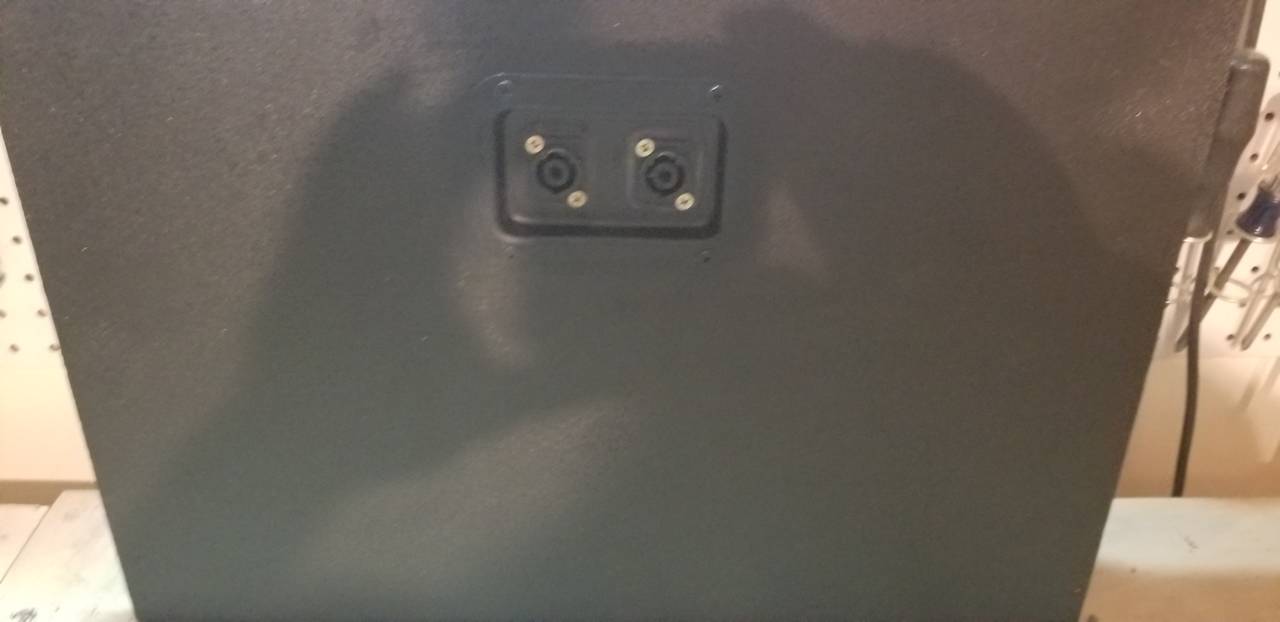

Hey, everyone. Some may remember I started an Otop 12 build while I was stationed in Germany. I think that was in 2015 at some point..... Needless to say I didn't want to spend the extra cash for European equivalents, wait on orders from the States, etc... So I just waited until I got back. So here we are in balmy Minot, ND. I got my 1 car garage workshop put together, and I finished the rest of the speakers. I had to re read the plans several times, locate the proper wood, purchase a drill press, table saw, and ban saw, and it paid off. There are definitely better builds out there, and some worse for that matter. In the end, they're square, air tight, and look pretty good. All I have left to do is put together one more tweeter array and Voila! It's testing time. After the new year I start on Titan 48s.

A few more

A few more

The last ones I have

Hey welcome back!
Both home, and to the forum.
Nice builds.
Just a couple of tiny little things you might like to address.
Take a little more of your damping material away from the vicinity of the crossovers. They might get hot, you don't want fire.
Also, take the damping material away from immediately behind your driver magnets. The magnets are the heatsinks for the drivers, they need a little room to do their work...
Nice builds.
Re: Omni Top 12 build from Germany
Will do, Grant. Thank you for the tips!
