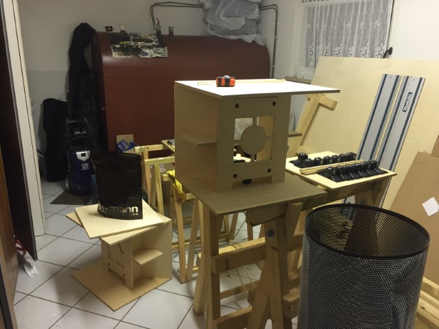

I first cut all plywood parts for both Jack 112 according to cut list in plans. With aluminium guide rail for circular saw I was quite accurate for inexperience woodworker.
I was actually cutting 2 plywood at one time where I could, so in one cut I got pieces for both speakers.
When I had all parts prepared i started with assembly. I was using Torx screws 3,5mmX30mm and 3mmX20mm and PU glue.

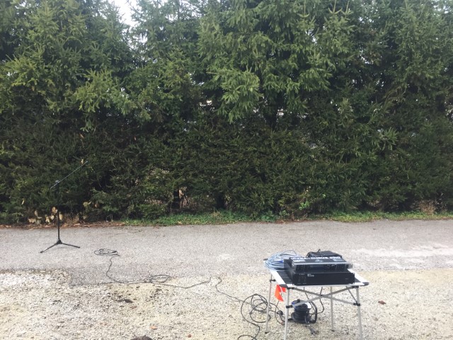

Did you use the "target" in the tutorial?
If yes, that is a mistake. You need to set your target based on the SPL charts for the J12, and you will get different results.
If you need help with this, please let us know
You shouldn't try to EQ inside. Your J12's are not hi fi speakers.
Do your auto EQ outdoors only, with at least 17m of clear space to the nearest obstacle (eg house shed etc)

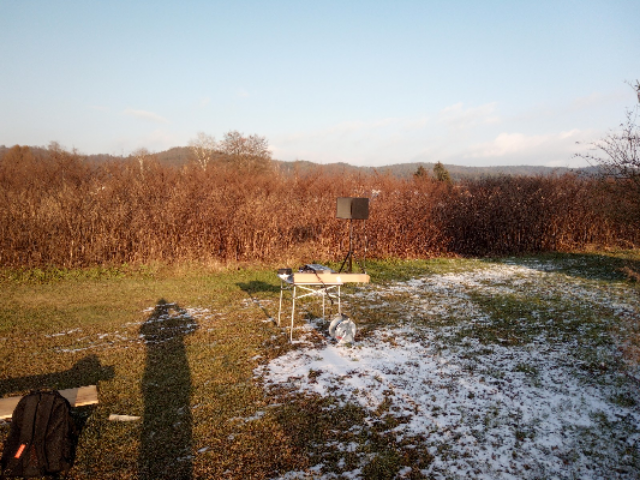

Chris_Allen wrote:The auto EQ doesn't look weird if you did it inside, the room will account for most of that response but you should not need that much correction.
In picture attached there is AutoEQ from outside, let say that cabinet was couple of meters from the car and 7 meters from house(left side from speaker) and Microphone was 8 meters from speaker.
There are couple of + 15db spikers an that bothers me. I did AEQ from 80Hz and UP in this picture. It didnt have enough low end and it didnt sound good inside. I didnt try any music outside just pink noise.

What kind of mic did you use? It should be an omni reference mic - not a vocal mic.

You're not going to get a lot of bottom outdoors because there's no boundary reinforcement. 15dB of boost or cut is too much. Where the program wants to apply that much back it off to 10dB, which is as much boost or cut that you should be using.

I am using Superlux ECM999 Measurement Microphone - condenser (15-48V), 20Hz-20kHz
Bill Fitzmaurice wrote:You're not going to get a lot of bottom outdoors because there's no boundary reinforcement. 15dB of boost or cut is too much. Where the program wants to apply that much back it off to 10dB, which is as much boost or cut that you should be using.
OK. But should I boost(Include in AutoEQ) Low frequencies from 40Hz to 80Hz?
Is +15dB and - 15dB normal thing?
Posts: 28982
Re: First Build 2x Jack 112 pics and questions
You should not boost 40-80Hz. That's where power and excursion demands are highest, especially as the cab sensitivity drops below 80Hz. That's not an issue with electric bass, since with typical cab placement on stage you're getting 1/4 space loading. It's not an issue with PA when elevated, so long as you're not putting a lot of low end content through it. In PA applications where you need more lows than they can deliver use subs.
#14 Post by Grant Bunter »
Target curve.
The easiest way to get a target curve is something called mirror imaging.
Use this SPL chart. The first one at the top of this page:
viewtopic.php?f=12&t=8778
Copy it, paste it into word, print it out.
Get a pencil and draw a ruler line across the chart at 97.5dB.
Set all frequencies on your DEQ to 0.
Whatever is above your pencil line in the J12 response on your printed chart needs to be reduced on the DEQ.
I'll give you some examples:
40,50,60,70,80,90,100Hz, no change.
125hz, change from 0 to -2.5dB
250Hz, change from 0 to -5dB
300Hz to - 7.5db
400Hz to -7dB
500Hz to -7dB
and so on, right across the chart to until you've covered all the frequencies.
You will notice the largest reduction will be around 10KHz, reduce by -10dB there.
When you're done, it should look like the reverse of the J12 chart on your DEQ screen.
For 20 and 30 Hz, set them both to minus 15dB.
For 20KHz, you can probably go -15dB there as well.
You've now set a proper target curve for your cab(s).
Auto eq outside now, with at least 17 metres of space around the cabs.
Once you have done that, save it.
Get back to us...

I have made "target curve" using mirror imaging. I have made AEQ from 100Hz to 16000Hz. Then I have manualy reduced the -15dB peaks to -10dB peaks.
I tried and played some recorded Youtube music and the Jacks 112 sound very good to my ear, but I will probably build one Titan39 to go with them because I miss a bit low end(they are on stands).
What do you think about this values? Are they OK?
