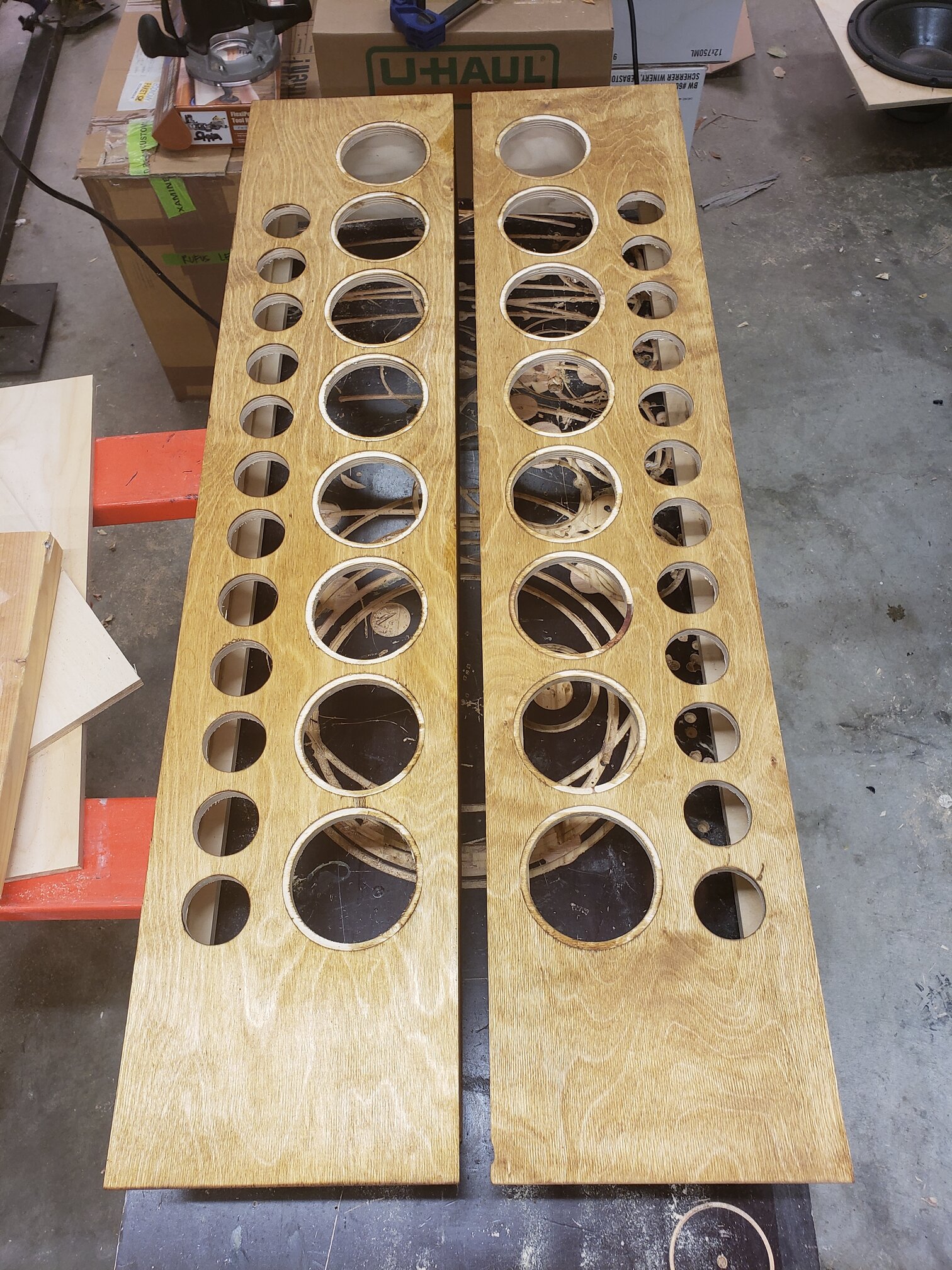

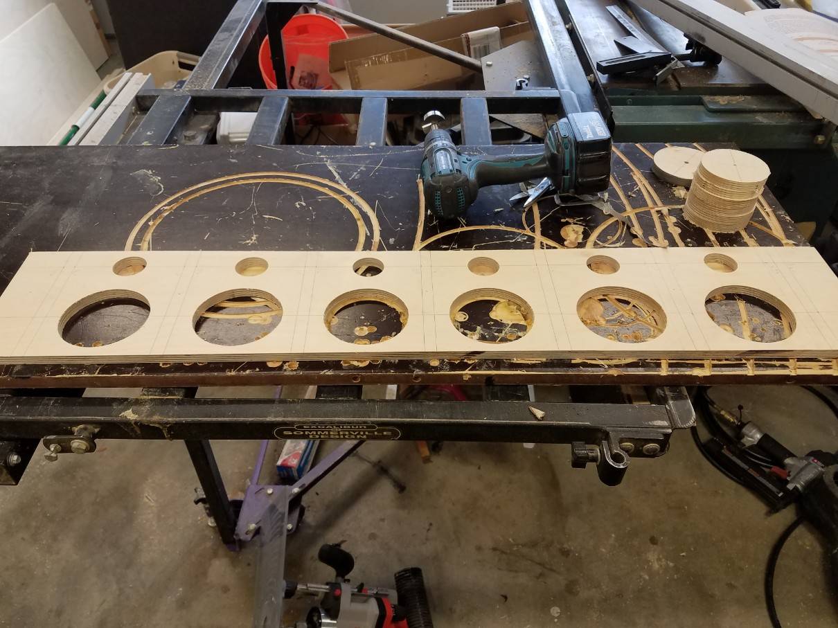

After discussions here about the best way to make the woofer holes, I tried:
First I tacked the curved SLA baffle to my work table with a few brads, nailing in the 1/2" wide strips that would be cut away: Then using the router, spiral bit and jasper jig, cut the woofer holes:

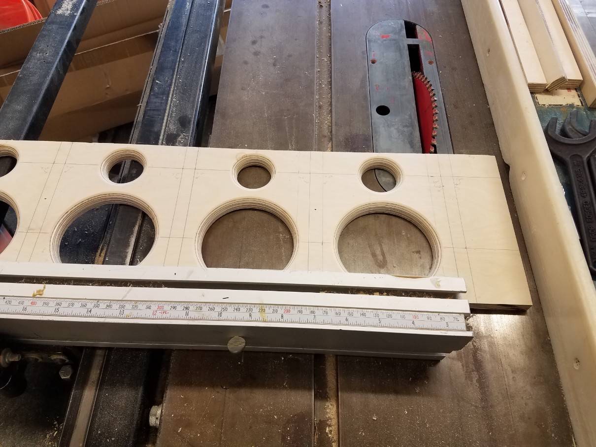

I used a Forstner bit for the tweeter holes - it makes a very clean cut. Here is the baffle with all 12 holes: Next I changed out the plunge base for the regular base, and mounted the 3/8" round-over bit and rounded off all of the holes: The final step was to make all of the angled cuts in the panel, leaving me with 8 pieces. Here is a dry fit of them standing up: A careful reading of the instructions reminded me that I now need to sand and finish these pieces before I glue them together. I also need to make the jigs that will allow me to make symmetric pilot holes for the mounting holes for the drivers. Tomorrow while the stain and polyurethane are drying, I may try to get the first couple TTLS panels assembled.

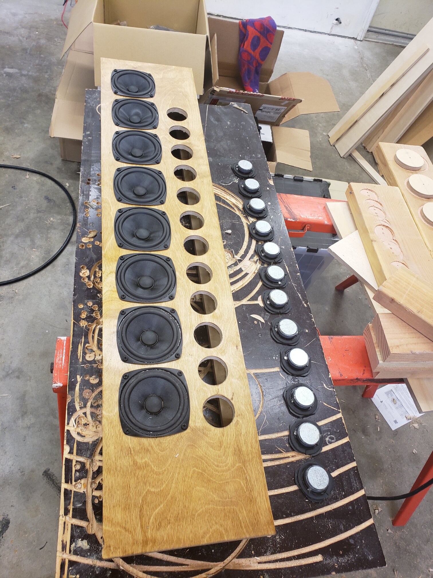

One of the things that took forever on the curved SLA was the decision to rear-mount the drivers. I needed to build templates to accurately place the 4 mounting holes for the drivers. Here are teh jigs I built: After drilling mounting holes and mounting drivers, it is starting to take shape: The woofer template uses a wooden disk to center it, while the tweeter uses a bit of 1 1/2" drain pipe. I also went through several iterations before settling on 5/8" long screws.
