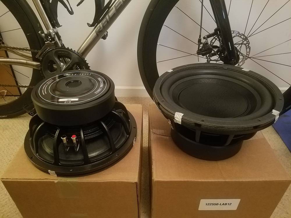

In the mean time here's some Driver/Bike porn..
Alex

Does anyone know why each LAB12 comes with 2 gaskets?

Two gaskets to provide the option of front-loading or rear-loading.

Tom Smit wrote: Thu Mar 29, 2018 9:53 pm Two gaskets to provide the option of front-loading or rear-loading.
That's what I guessed but it seemed odd as you would only need one as a)the front has a built in gasket b)you only ever mount from front or back, not both.
Hey ho at least I have spares now..
