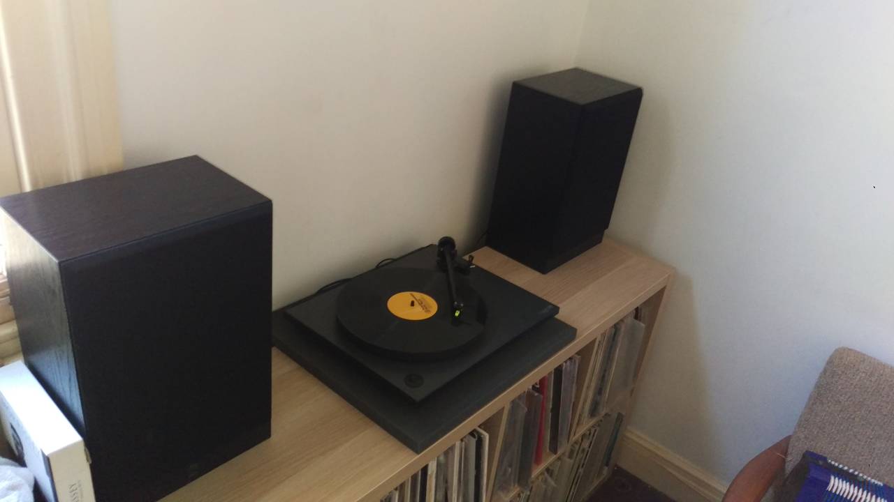

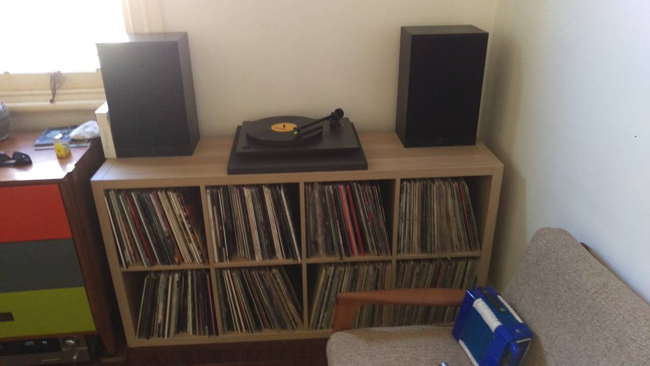

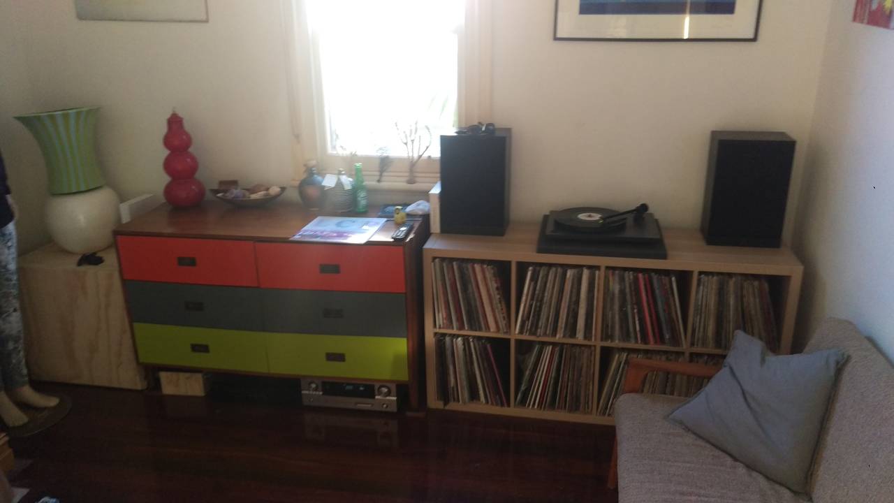

I went round to the varnish cab friends place yesterday to solve the record player feedback issue. The fix was simple. I bought a piece of medium density foam, about 50cm square and an inch or so thick. We put the record player on top of this, and were able to crank the system to full noise without any needle skipping or feedback. It doesn't look too bad either..
