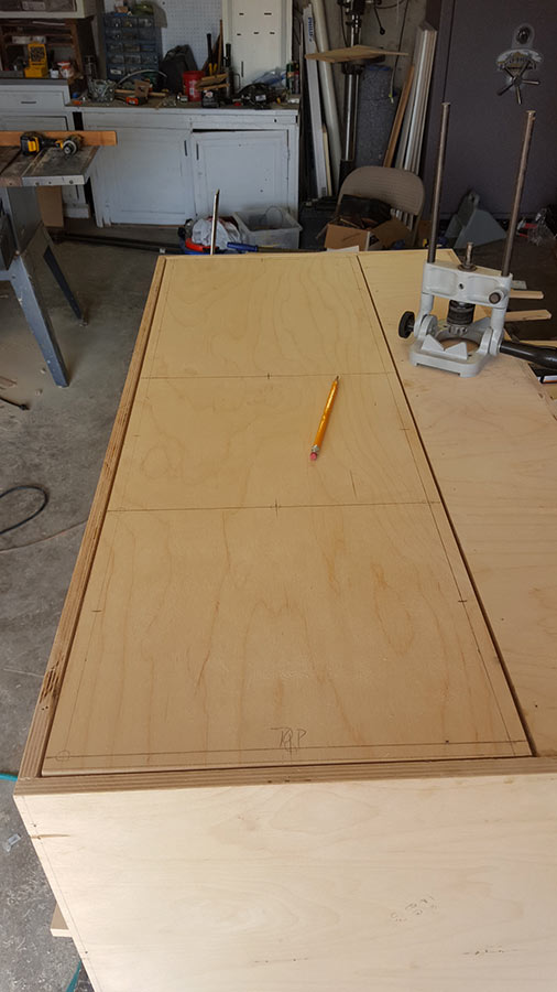

Back is cut and here I'm marking the hole locations.

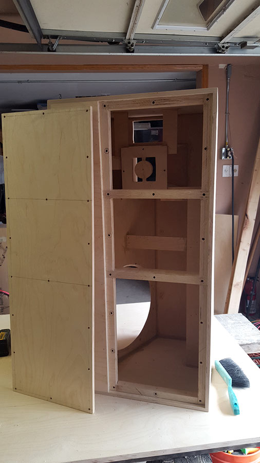

Back flanges, internal braces and horn installed. I've also installed t-nuts in the flanges to hold the back on.

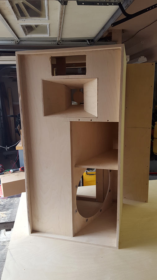

View from the front.

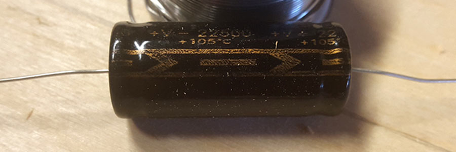

Another noob question. The schematic for the bandpass crossover appears to show the negative end of the 22uf cap connected to the positive input from the amp. The capacitor I bought is polarized. Is there any issue with connecting the negative lead on the cap to positive input?
https://www.parts-express.com/ruby-gold ... r--020-668
Have you ever picked a dandelion and then held it in your hand and flicked off the flower? Cause if there is more than 3 or 4 volts going the wrong way through a polar cap that is what happens to the top of it. As audio is AC it gets current in both directions. I don't have the plans in front of me but I would double check to see if a polarized cap is acceptable.

#44 Post by Bill Fitzmaurice »
Crossover caps are never polarized.

Bill Fitzmaurice wrote:Crossover caps are never polarized.
I'm disappointed with parts express. All the caps I bougt from them look like this:
Notice the arrow pointing to the negative lead. Guess I should have bought parts from Leland.
