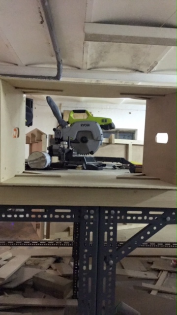

Hey guys! So today is the first day of this build log. I had all the wood delivered from the CNC machine around noon, and started building immediately. This thread will be updated every day for the next week, as I hope for them to be done this friday! I already had 4 titan48, that is why I am only building 4 in this round. Please tip in with as many tips and tricks as you can! I am not the most experienced woodworker in the world.... And sorry for 2 of the images being flipped! Not sure how to de-flip :lol:

More progress! The baffle on the top cabinet got shifted a bit, i hope it doesn't affect the sound top much...
