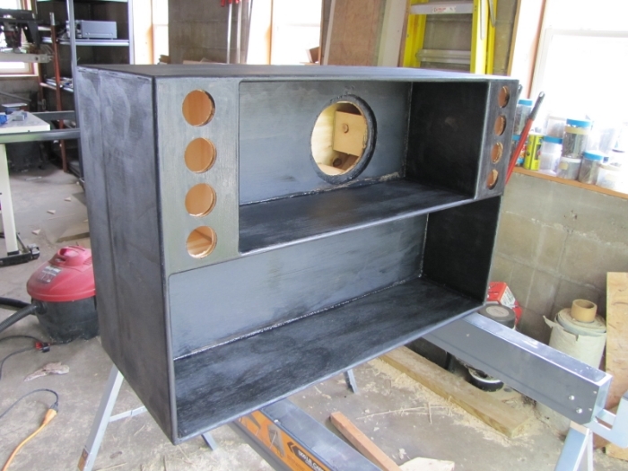

Here the bottom shelf goes on, and I've drilled out for the 4x4 mid/full ranges. They are Peerless 2" that are flat to 16KHz, and then slope off 10dB to 20k, so I figured they'd sound OK in a small space, and they do. I had to put one of my clamp beams on to work some warp out since I could not get to the back side anymore to pin with the nail gun. You might notice my extractor tool, great for when you drop screws and drill bits and things into tiny holes and have not cut access panels yet...

The primed box after rounding the corners with a 1/4" roundover.
