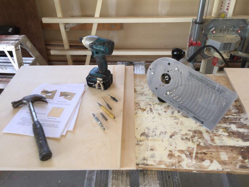

OK I'll try and post some photos here, spent several hours in the shop today. Primarily finished up panel 4 for each unit, I have an extensive workshop, one advantage of 70 years is the time to accumulate the toys!!! Shots are, in reverse order.
My Jasper Jig ready to make those baffle cut outs,
Some tools used, I had a hinge screw centering bit that perfectly centered pilot holes for the intended socket head wood screws now on their way from Parts Express.
