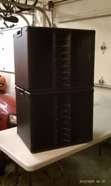

Well whaddy'a know. Here it is, more than two years later and I finally found some extra shots of these, my first build. (sorry, was in the bathroom)
Better late than never eh? And don't hold your breath here, the shots would have been better but I can still hear the laughter of the Olan Mills staff when I brought them in an began posing them. (It's a painful memory and I don't like to talk about it)
So we'll all have to be content with a garage shot on a cheap plastic table.
In all their original glory:
So there you have it- CLOSURE!
*whew*
And I still don't care what crafty thinks.
ONWARD!
*whew*
ONWARD!

I like the handles you used on those. Where did you get them? My Jack has the heavy spring loaded steel handles. Yours look very clean.
Re: 2 Jack 12's - first time cab builder
- James Champer
- Posts: 301
- Joined: Thu Aug 23, 2012 7:00 pm
- Location: BF Builder - Indianapolis
What he saidLelandCrooks wrote:http://www.speakerhardware.com/small-ri ... handle.php
And yes, they work great on the Jack. Low profile, good carry spot, comfortable. I like them so much I put them on both pair of Jacks I've built for myself, and suggest them to my clients.
