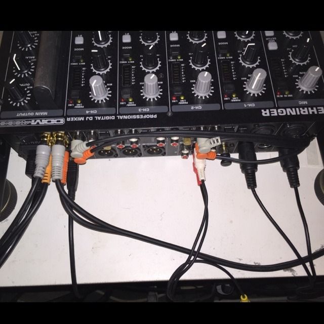

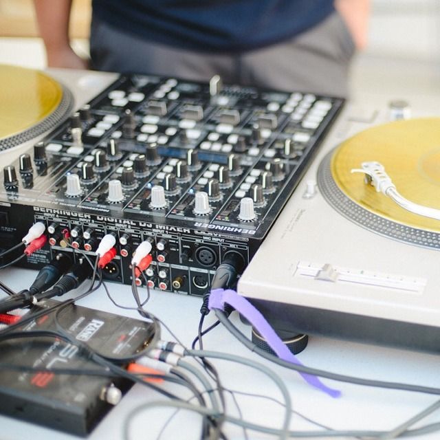

heres some pictures of my work.
Before:
After:
if you have all the parts it really can be completed in less than a couple hours. sorry i didnt take any pics of my process of drilling holes. for the RCA couplers, use a step drill bit to cut the holes. i wish i figured that out earlier in the process.
With the new Denon DS1 sound card that looks almost as small as a smartphone, i think this mod can be done on almost any mixer.
