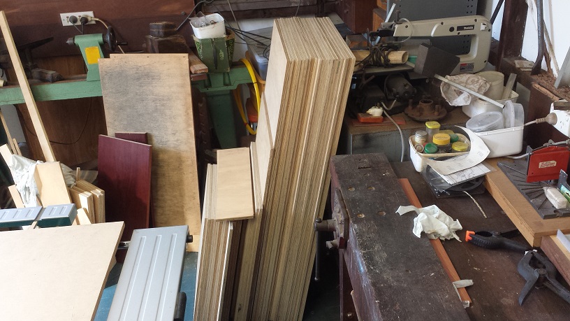

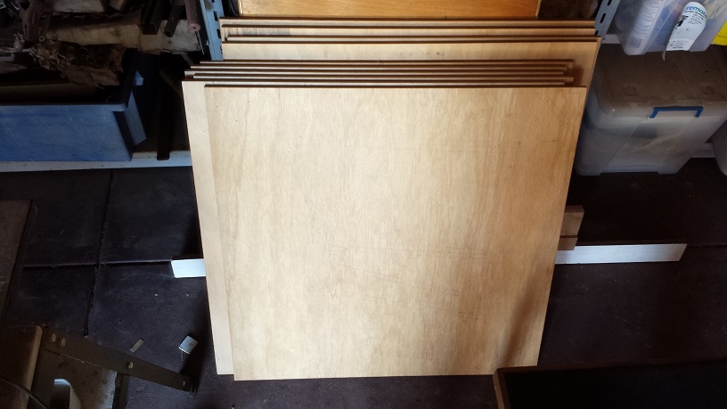

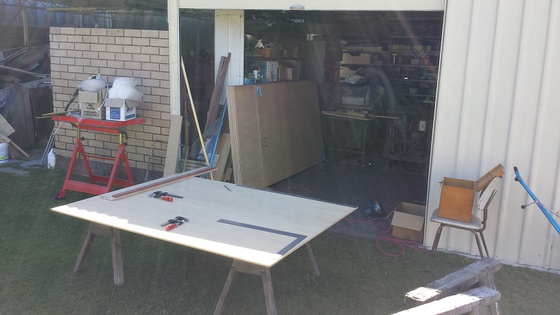

Day 5/6: So, we had a successful 14 hour day on saturday. We started at 0700 with a trip to bunnings, bought 8 more sheets of plywood and got cutting! All 10 sides cut, and also all the panels cut to widths and rough lengths. We managed to get 2 sides marked up by 2300 which was when we decided to call it quits. We completed the remaining 3 sides on Sunday afternoon, and drilled and marked up the nail lines on the opposite sides, which is all we had time for this session. We packed everything up and will commence cab 2's build in a weeks time.

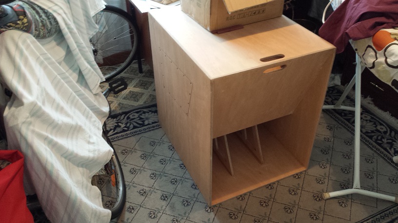

A quick pic of the 1st cab all sanded and prepped for finishing. I have a question regarding duratexing options and would like peoples opinions on whether to 'tex the entire cab including all visible horn mouth area or just the outside of the cab and use matt black paint for the rarely seen inside of the horn mouth/brace/throat area? I know at the end of the day its down to personal choice, but would like opinions nonetheless. Duratex is expensive here in aus and I'd like to make it go as far as possible. Also, will 1 gallon do 1 cab or will a cab (of my dimensions) take more than a gallon? Thanks in advance!

Look at the pricing of "Rockard", I hope it's still available as per the Aussie suppliers thread.
It's ultra black, the texture version pops up some nice peaks.
A 15 litre drum did 4 x T39's at 20", 2 x DR250's, 3 x WH8's (exteriors and mouths on all these) , and a 13RU FX rack.
No primer on any cab or rack.
At least 2 coats per cab were done.

Np thanks Grant. I will decide this week which way to go. I have already bought the duratex so hopefully it'll go as far as the rockard stuff you used. If that's the case, then all will be good and the mouths will get done as well (looks better IMO).

Alot of the threads i've seen they paint the entire cab in black latex first, cheaper, and it seals the wood. then you can get away with a lot less Duratex. Not sure about brands down under, but Rustoleum makes a nice premixed black latex. I used it to seal inside my THT and was quite pleased with the results. And I would paint and leave the mouth, save the 'tex for the rough and tumble outsides!

So are there any issues with the duratex not bonding adequately to the plywood if there is already a coat of paint on it? I definitely like the idea of giving the whole cab a coat of paint (I bought 2 cans of Rustoleum Matt Black for the horn mouths) to soak into the wood to save on duratex, but I don't wish to do it if it is going to compromise the strength on the 'tex in any way. Any advice?howiez wrote:Alot of the threads i've seen they paint the entire cab in black latex first, cheaper, and it seals the wood. then you can get away with a lot less Duratex. Not sure about brands down under, but Rustoleum makes a nice premixed black latex. I used it to seal inside my THT and was quite pleased with the results. And I would paint and leave the mouth, save the 'tex for the rough and tumble outsides!
