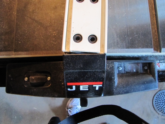

Ok, we're off...and the first snag...
lets check the square on that fence...
I saw a nice video on cutting round shapes with a table saw, I'm going to pass after this...

Yes, those pictures are from a while ago. I had purchased all my wood on Fathers Day. That was my day to putz in the shop all day. Both my sons helped me cut the 4x8 sheets down into manageable chunks with a saw guide and circular saw. But when I started using my table saw to make nice square pieces, I had that little detour with a broken fence. I can't stress enough to people to be careful of kickbacks. BFM's sled works much better than just a fence for cutting short pieces like that hexagon flange to thicken the mounting...
Anyway, this set me back a few weeks. I was worried i'd be out several hundred for a new fence. Lucky me, Jet was able to get me just the T that broke, and a handle that I broke last year for well under $100. I love my Jet 10" SuperSaw. And just in case anybody is curious, I have a 40 and 60 tooth Freud blades. I love them, clean them with a little oven cleaner when they get pitched up from all this flippin' pine!
