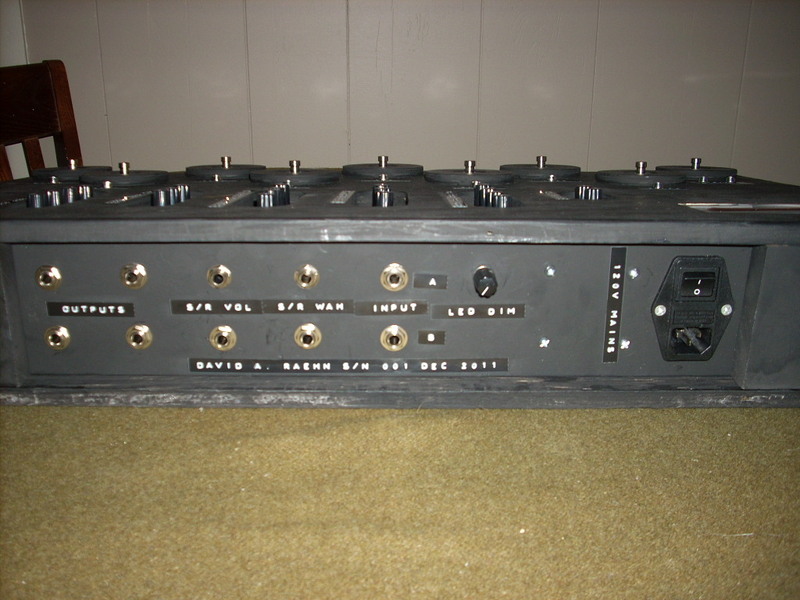

A quick question though... how did you create the holes in your 2U patch panel? I'm pretty sure this isn't an off the shelf part, and i'm intruiged how you made the holes for the various connectors. Looks very neat :)
I now use NA3MDF & NA3FDM passthrough connectors after yanking the wires off soldered XLR chassis connectors far too many times. They may cost more AND you need an extra XLR plug to go on the 'internal' side, but it makes life so much easier when re-wiring my rack. I just have a row of them and connect them up as I need them on the day.

David Raehn
Posts: 676
Location: Colonial Beach VA
Re: BassheadUK Build Thread - Rackmount & 2x Lab12 T39's
#9 Post by David Raehn »
I haven't switched over to powercons yet either....
I start with a stepped drill bit and finish with a jigsaw. If I did enough of them I would splurge for the correct punch tool, but they're expensive.
