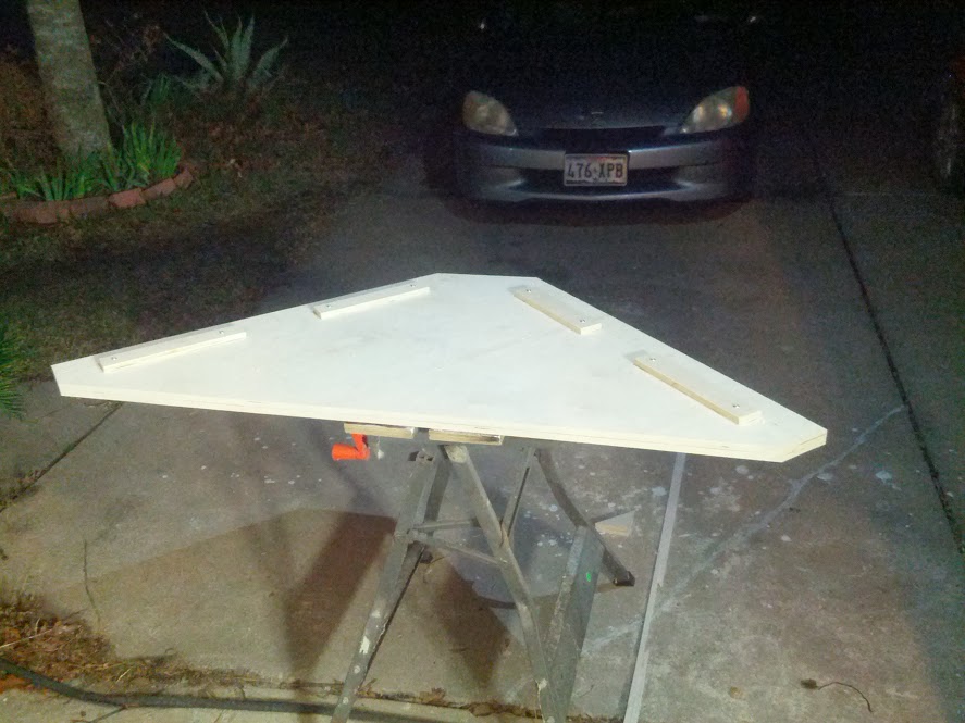

I'm trying out a variation of the metal clamps...same idea, just wood. We'll soon see how it works.

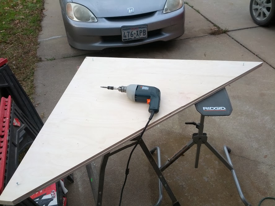

Two sheets of BB glued together, edges later given roundover
Blocks to rest against the T39's

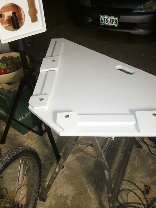

Clamps are BB with an extra edge strip sanded at an angle

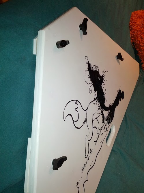

Top decorated with a psychadelic fox

Love the fox. Very artistic. Freehand?

Scott Brochu wrote:Love the fox. Very artistic. Freehand?
Thank you! It's just a freehand copy from Michael Gagne's 'Saga of Rex'...
http://www.gagneint.com/Final%20site/bo ... a_main.htm
And yes, the fox song will be played |)

Finished! Here's a detail of the clamps and the lawn mower nuts. (thanks mr. Weldy)
I was worried that there wouldn't be enough 'play' for the clamps to tighten down but it's not a problem. Used dremel to square out the hole slightly so the carrige bolt would stay in place, might give it a dab of glue to keep it there.
Clamp detail
Clamp detail
Bolts in place
Bolts in place
