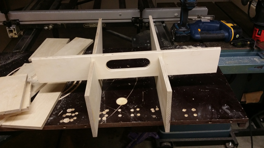

On my second cabinet I'm up to the panel 6 extension, which I installed today:
I think I did a better job of squaring things up on this one, and used the recommended jig to get things aligned. And you can't have too many clamps! Next are the access panel flanges. I'm starting to see the light at the end of the tunnel.

I think that as long as the side meets the outside panels nicely, it should be good enough because the PL will fill in the gap. Make sure that there is a nice bead of PL on all the edges.
Before you put the last side on, paint/Duratex the mouth as far in as on can see. You can use a straight-edge, to assist in finding this out, by placing one edge against panel 10, just catching 5/6 joint and ending at panel 8.
Re: My Titan-39 build
#60 Post by DJPhatman »
+1 to Tom's suggestion. Paint the interior, and the mouth braces, now, while the second side is off.
I would take a hammer to each brace, not too hard, to test for loose glue joints. You should be able to easily hear the difference if a brace is loose.
If you know where the high spots are when attaching the second side, knock them down a bit with sandpaper. Only takes a few minutes, and this is your only chance to do it.
