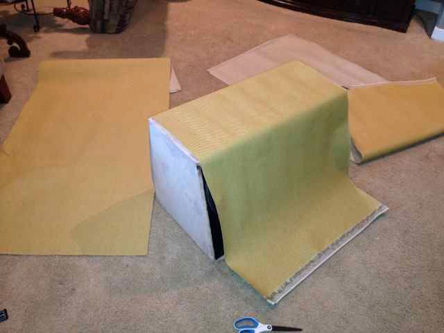

Image Sizing and cutting the tweed panels.

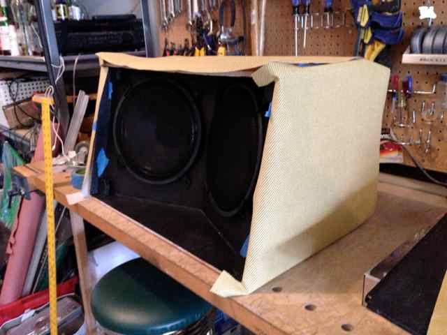

Image Covering coming along. Note the "horns" at each top corner. Those are formed because I rounded all edges except the top ones. Keeping in mind that I'd be putting an amp/cage on top I thought it'd be easier and look nicer to mate to straight edges, not rounded ones. We shall see ...

Cab looks better in better light than my garage provides:
Okay, time now to confess my sins. The quality of the craftsmanship around here is pretty intimidating for a rube like me, so I almost didn't post the next pics ...
The back came out a bit blotchy. I should have left well enough alone, but there were a couple of stains around the removable back's latches where glue had seeped onto the tweed and the shellac dyes it much darker than dry tweed. In my efforts to correct it, match color, try to rematch again, correct the correction, etc., I probably made it worse than if I'd just told my son to live with it. Good thing is, it's the back. Not the top, front, or sides which I'm still pretty pleased with. (In my defense I will say that the pixelation in some of these pics makes it look a little worse than it really does in person.)
For awhile I was pretty discouraged about it. But once I changed the goal of this project (ex post facto) from producing a cab with a "new out of the box look" to producing one with a "pre-distressed, banged around, late nights in smoky bars for decades" look, I could rest comfortably knowing that I clearly had accomplished my objective. Never underestimate the power of re-writing history.

Question: I know tweed is pricey, so how was it to cover and glue since this will be my first cover job?

Jimbo7 - it wasn't a difficult process, just take your time. Do one panel an evening if you want. I used Loctite (sp?) II wood glue, spread evenly over the wood, then pressed and smoothed the tweed down. You'll get the handle on corners. Then two coats of lacquer, as many coats of orange tinted shellac as you need to get the color you want, followed by another 2-3 coats of lacquer again. I found this thread here to be VERY helpful: http://www.harmonycentral.com/t5/DIY-Do ... p/31339857. Good luck!
Edited 10/29/13 - Also meant to remind about being especially diligent about not letting glue get on top of the tweed. I would spread the glue about a 1/2" shy from any fabric edge. Pressing it usually got the glue up to the edge without leaking out. If you look at latches on the removable back (in the very last pic) you'll see what looks like darker shadows partially surrounding them. Glue on top of the fabric. Didn't show up when I laquered but was their immediately when the shellac hit, like invisible ink suddenly being revealed. Its those buggers that put me on my "try-to-fix-it, match-the-color, make-things-worse, better-just-learn-to-live-with-it" odyssey that I mentioned above.
