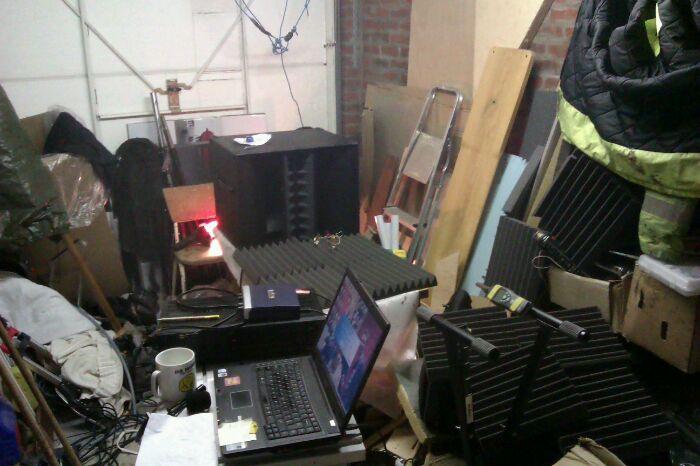

OK, I think I got a good result. It's been chucking it down today on and off, so I'm feeling this is gonna be as good as it gets, though I do like the idea of doing it properly. See picture below.
In the picture, the J12 array is 1.25m from the SPL meter (centre right of picture held onto keyboard stand with yellow tape) which is pretty much on axis. I set the DPDT switch up (just in front of the cab on the acoustic foam) to be easily able to switch array on, In Phase (IP) and Out Of Phase (OOP) and off - I like easy repeatability. There are 2 sets of results: First set is where I had initially put some acoustic foam on the bench in front of the cab and some on the 2nd cab just under and to the right of the SPL meter. The second set of results was with more foam spread around - 2x1sqft pieces held against the garage access door with top end of broom handles (brooms just seen in bottom left of picture) where in-plane reflections off the door would be, and some on the shelves to the right, and some stood on the general piles near there leaning against the vertical surfaces, again roughly in-plane with the cab and meter. The cab back was propped in place so no rear reflections. Firstly, I stood against the garage freezer (out of picture to rear left) and got a stable-ish background reading (silence) of 43.4dBC (ish). All subsequent meter readings were done with me standing with back against the freezer.
1st set of results: foam just on bench and on top of spare cab:
main driver alone = 83.4
IP array = 87.4
OOP array = 79.0
2nd set of results: Extra foam on door (to left) and perched on right side shelves
main driver alone = 80.8
IP array = 85.7
OOP array = 76.5
Unless anyone can see any glaring mistakes (other than living on a wet, crowded Island) please let me know, but I think that's it.

That's OK to measure the response in that room with the cab in that spot with the mic where it is. To measure just the cab you need to do it outdoors, well away from any buildings. In use you do need to measure the room, typically with the mic placed in the middle of the primary listening area.
