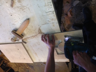

and heres to cutting the baffles
- Attachments
- photo-4.JPG (35.01 KiB) Viewed 4010 times

it's not a good idea to have your hand in front of the jigsaw when cutting your workpiece.Uksounds wrote:and heres to cutting the baffles

Its not my handleamy_f wrote:it's not a good idea to have your hand in front of the jigsaw when cutting your workpiece.Uksounds wrote:and heres to cutting the baffles
