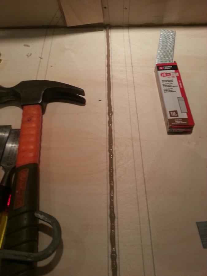

Thanks for all the replies.  I expected to see more of the PL premium coming out of the sides of the joints than I do.   How big should the bead of PL be?  Will it expand ovenight?  I attached the side to panel 1 around 7pm.

How are you securing the panels to each other?  Screws or brad nailer?  I realize that with PL, the panels slide around a lot when you're trying to get them aligned and nailed down. That's all part of the fun, my friend!  Ideally, you want to PL the joint, line the two panels up together, then drive one screw or one brad just to hold it in place.  Then you clamp the crap out it and continue to screw/nail it in place. Then you don't touch it until the next morning.  These cabs are not jigsaw puzzles that can be assembled in one sitting.  That fact is frustrating to me as well.
The size of the PL bead depends upon how much space it will have to fill. I.E. if your cuts are all precisely the correct size, and when you dry fit the panels you can't see any light peeking through that joint ANYWHERE, then you only about a 1/4" wide bead on 1/2" material. If you have gaps to fill, slather the PL on there and let it sit overnight. PL EXPANDS big time as it dries, which is exactly why it is so important to let the assembly sit overnight. If the whole thing is clamped AND the temperature in your assembly room is over 80F (PL is VERY temp sensitive AFA curing goes), you can probably get away with removing clamps after 8 hours or so.
When PL is fully cured, it's like concrete. It's impossible even scrape the crap off, let alone break a bond b/t panels. But you've got to let it cure.
If you don't see a lot of sqeeze out, that POTENTIALLY means that joint is not air-tight. If possible, hold a flashlight on one side of the joint and eyeball the other side as you slide the flashlight around. If you see light, you need to slather PL in that area. NO squeeze out is bad for sure. A little squeeze out PROBABLY is not bad. Lots of squeeze out is great, but also means you used too much PL on that joint. PL usage and cab building is a learning process. I can dry fit two panels and know exactly how much PL I need to use. That said, I still make a lot more mistakes than I should at this point. Check my build thread, link in sig for some potentially helpful hints.
*edit*
Saw your pic. IMO you need to be laying down a wider bead of PL and really clamping those panels together. Bill's designs are pretty forgiving of "airspace errors" but they absolutely require airtight joints. Particularly with one of the subs, that puppy needs to be airtight. PL is cheap; blown drivers aren't.

Ok thanks miked.  I'm hoping there will be more squeeze out by morning.  If not I will PL the seam and use more on my next panels.   I am going to screw together panels dry the remove add PL then re screw.
						Re: THT LP build
PLing the seam, AKA "a finger fillet" works very well. PL seals airtight, just like silicone does, but once it dries, it grabs like concrete, which silicone does not. In my Omni Top build, I "finger filleted" many of the joints, even though I probably didn't have to. It's a holdover habit from 20 years ago when I would build subwoofer boxes for the trunks of cars and use white bathtub caulk to seal the joints.slinger wrote:Ok thanks miked. I'm hoping there will be more squeeze out by morning. If not I will PL the seam and use more on my next panels. I am going to screw together panels dry the remove add PL then re screw.
 Old habits die hard.  But again, PL is cheap.
   Old habits die hard.  But again, PL is cheap.PL expands as it dries. Whatever squeeze out you have after 3-4 hours will not significantly expand in the following 3-4 hours. "PL fillet" that joint, let it dry, and move on.
