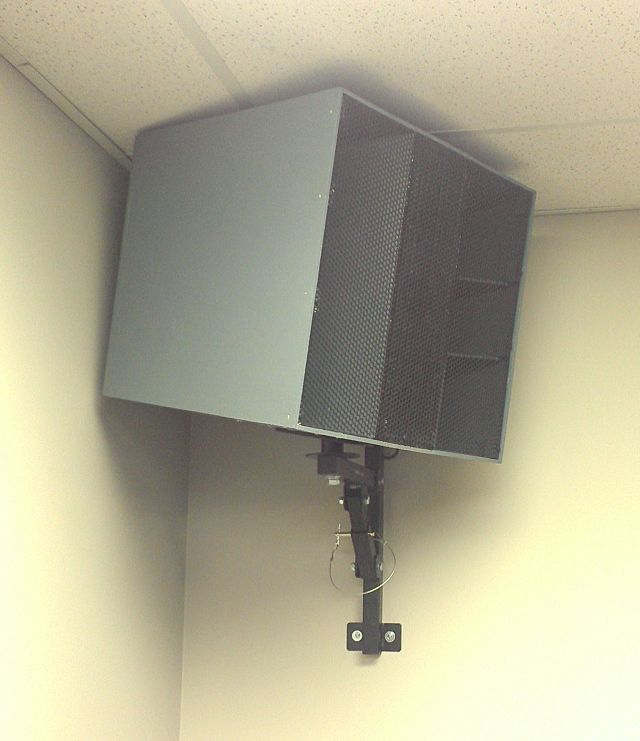

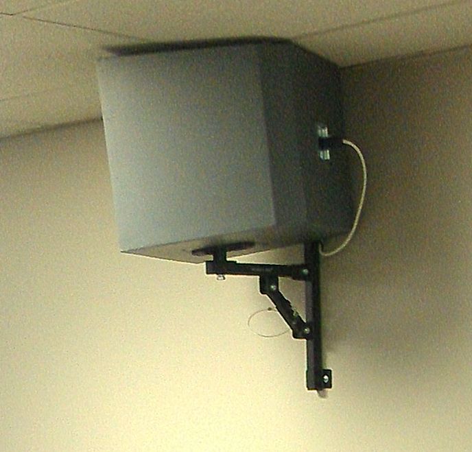

This is a recent install that uses light weight DR200s and a light weight T39. The T39 was light enough that I hoisted it up on my shoulder to carry up a flight of stairs. Normally I reinforce the lip of the mouths with hard maple but since this was a permanent install there was no need. Properly built with reinforced driver chambers any of the Tubas and Titans can be built in a light version. I also build the DR series in a light weight version. These speakers are very durable and should hold up to years of use.

Nice!
Those adjustable top hats come pretty handy :mrgreen:

Very nice Rick! Did you get to weigh them? Great bracework on the sub.

Thanks y'all. Yes, I weighed them but forgot to write it down... They're both very light. I THINK the T39 was a little under 40lbs with the non-neo driver. The DR's were 20 something. Light enough that I don't intend on building fiberglass composite cabs any more.
