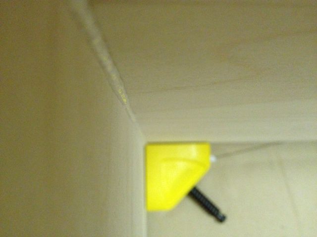

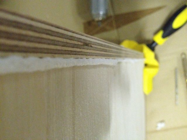

I joined the first two panels yesterday with the Rectavit Structan and it looks like this:
Re: Links to everything you need for your BFD-build, in Euro
It looks the same as Soudal 60A. Which is ok.

Apparently Rectavit is now owned by Soudal, so it might be just the same product after all...
I tested it, very very strong, even after 5 minutes...
i use structan . it expands the most out of all the glues i've tried so far. that and a good brad nailer and your cabs will be solid ass concrete.
