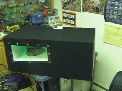

#37 Post by DJ Higgumz »
ooh I needed that extra volt! heres a pic all completed and ready to go!

#38 Post by Gregory East »
50 odd watts?
