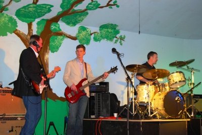

Finally got the J15 2515 bass rig out to a show. It was a charity gig at a church, so that explains the background. I had the melded array turned off. Our regular drummer got called to Brazil out of nowhere for work so we had to go with a ringer on drums. He said he really liked the way the cab sounds and liked being able to hear it. I was more worried about blowing him away.
The show turned out well. Everyone on the stage said they could hear the bass well, which was nice. I didn't have it turned up loud at all. The signal light on the amp barely flickered.
Now I guess I just need to build 3 more so I can have a 4-stack like the rest of the Jack guys.

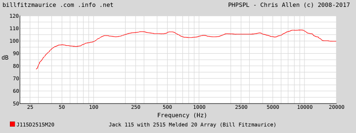

Did not find a J15 entry in the SPL tool on the site, but to me and my naked eye, its SPL graph appears to be very much comparable to an 8x10 loaded with Alpha 10's (8x10 is strong 105db from 100hz on, J15 from 120ish hz on, the rest looks close), does that make any sense or my morning coffee was spiced by my coworkers? :noob:

Hmm, but there is?

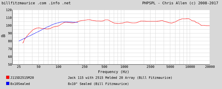

I guess my searching skills are below par :owned:
Ok, lets redo this:
Don't know why the graph on the 8x10 stops at 200hz, according to the comparisson with tens thread, the graph hugs the 105dB line from there on.
Ok, from this graph, a J15 kills the 8x10 in the 4th string's first few steps, but the bigger 8x10 gets too much advantage in the 60-110hz range, up to 5 dbs I think. EQ would put it in the same league?
I'd say "close enough", for a cab that size is quite an achievment!
