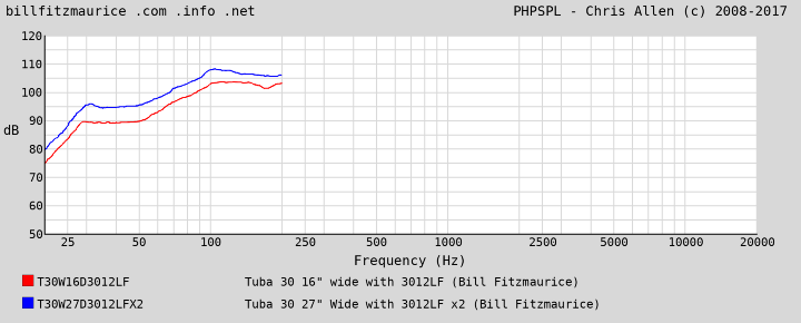

4 slims: Add 6dB to the dual chart rough enough, add a conservative 20dB for 1000W of power, add 12dB if you can corner load, add 3 dB for v-plate,
50hz @ 95+6+20+12+3 = 136dB 1m/1000W
I don't even know if that's possible.
