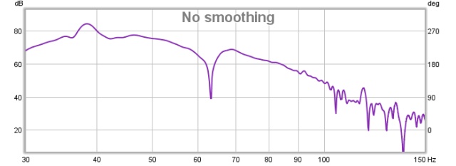

Thanks for the recent thoughts guys, I still think something is amiss with my setup. I did a quick run with REW, a sweep from 30hz to 150hz, mains disconnected. Some of the folks on another forum think the roll off should be steeper with the two x-overs inline (AVR and sub amp), what do you guys think?
Posts: 7652
Re: Table Tuba build!!
#158 Post by Tom Smit »
I am going to guess that the crossover is set at 50hz, and that there is a roughly 10db/octave rolloff..not much.

digital_chris wrote:I still don't freakin' understand.... how come I can clearly tell that my sub is in the corner, ESPECIALLY during music. What am I doing or not doing that is causing this?
Because the low pass filter on it is crossing over too high, and there's too much output over 100 Hz.

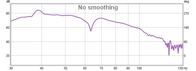

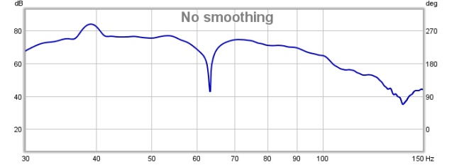

Here are two more I just took, purple graph is 60hz x-overs and blue graph is with 80hz x-overs.

The next octave up from 100Hz is 200Hz, which is locatable, so you want the slope to knock it down to inaudible, 10dB down is just half as loud, that's still audible.At 20dB down, probably still a pretty decent sniff of bass, I don't actually know what you need to get to inaudible, I just use 48dB /oct because I can, problem solved.

Both the AVR and sub amp have x-overs set at 60hz and 80hz relative to the two graphs I posted. From what I gather, with two x-overs inline, the drop off should be significantly steeper than what is shown.

10 + 10 is 20dB which makes 1/4 "loudness". That's all I know.
