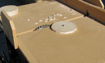

1) A way to cut the phase plug disks using a table saw instead of a router. (A bandsaw would be best, but I don't have one.) This is a lot faster than using a router.

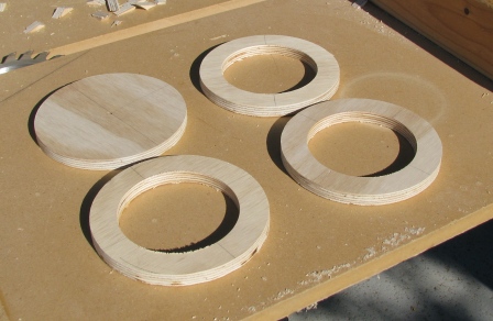

2) Hollow out the middle phase plugs to save a few ounces.

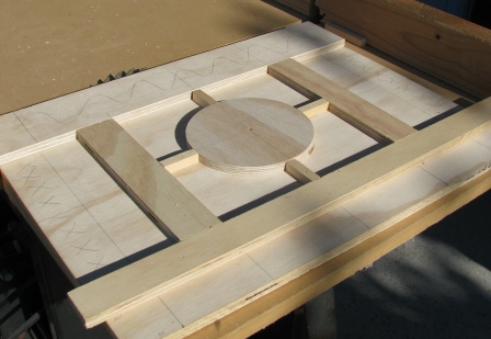

3) A template for the baffle is essential to getting a good result. Instead of investing in a full template for a single cab build, I created a temporary one by tacking a phase plug circle and some scrap strips in place with brads.
4) Then rough cut with a jigsaw and finish with a router.

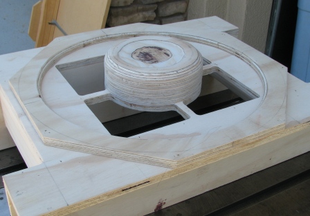

5) The finished baffle and throat assembly.

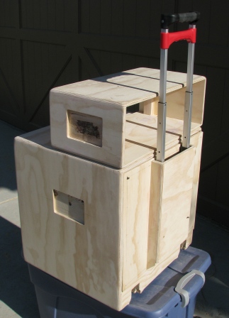

8 ) I made a luggage handle using hardware from a folding hand cart. The housing attached to the back panel gives it protection and a good anchor point. Also note the notches in the lower back corner for wheels. Finally, a 4U rack case tops it off. The rack case is attached to the main cab with machine bolts and T-nuts so it is secure, but can be removed easily.

I like the trolley idea. Genius. Looking really nice too, good job.

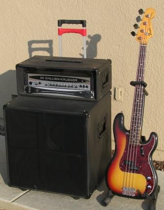

The finished result with a bass for scale

DaveK wrote:3) A template for the baffle is essential to getting a good result. Instead of investing in a full template for a single cab build, I created a temporary one by tacking a phase plug circle and some scrap strips in place with brads.
:clap: :clap: :clap: Wish I'd thought of that one.
A properly sized hole saw is even quicker :wink:

Jon Barnhardt wrote:A properly sized hole saw is even quicker :wink:
Good point. You would need a hole saw with a 5" *inside* diameter and a steady hand to avoid wobble. I don't have either :-)
This octagonal outer edge would have saved me much grief with my crappy tools; such a simple thing to overlook :noob: . Live and learn.
Nice build.

cheapbasslovin wrote:This octagonal outer edge would have saved me much grief with my crappy tools; such a simple thing to overlook :noob: . Live and learn.
I don't even bother with octagonal, I leave the outside square - less cutting time and really, it's bugger all weight saving going round or octagonal considering.
