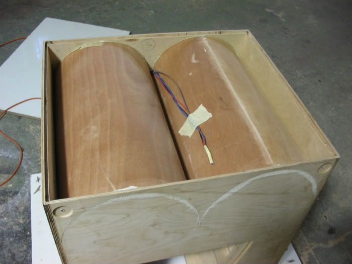

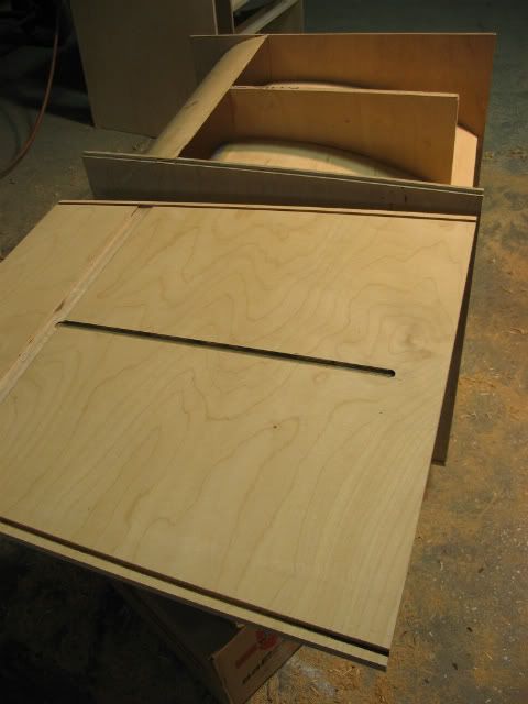

For example, here's a shot just before attaching the side panel of a DR290. The dados for the horn brace and the top/bottom panels were glued with Elmer's while the edge of the butt cheek was glued with the Montage Kit:
And here, attaching the back panel. Elmer's was used for the surrounding step, and a nice bead of Montage Kit was applied at the apex of the butt cheeks:
Note in this picture the squeeze out of the Montage Kit glue to the inside of the top/bottom extension to butt cheeks joining, and also the outside after sanding.
