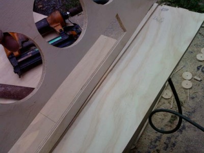

I decided to build some TLAH's that would be used much like the Bose L1's. Small or low volume type gigs. With the columns setup behind the band, so, no need for monitors.
I had some 1016 piezo tweeters and these drivers. The next decision was how big and how many drivers. After more reading and a question to Bill about dimensions, I decided on 12 drivers and 18 Piezo's. I wanted the footprint a small as possible, so the width and depth are midway between the home and pro dimensions, the overall height is 72".

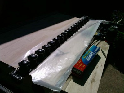

More

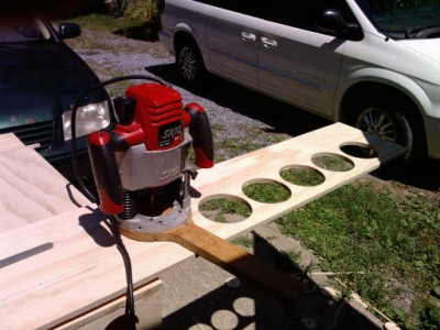

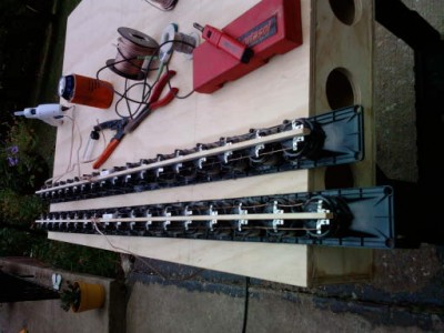

More
Final weight 36lbs.
