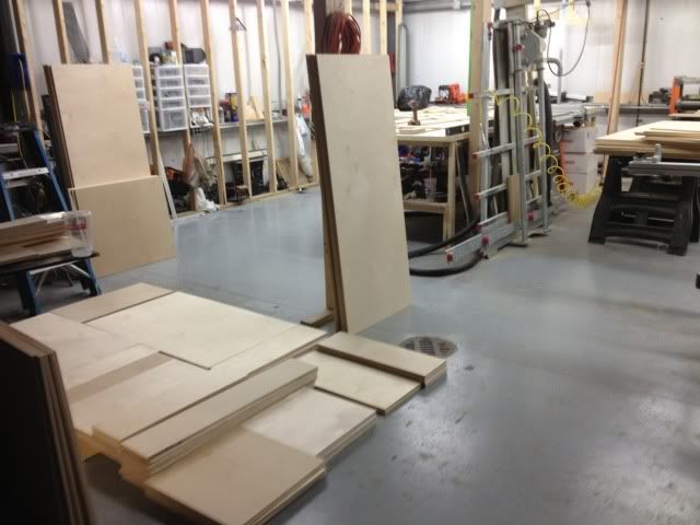

I noticed before (so now I'll ask), what is the stud wall for? It seems like it is removed from the wall by approx. 6".
I stole this space from my motorcycle shop. It use to be our parts room so I built a second floor to relocate the parts so I could build speakersTom Smit wrote:I noticed before (so now I'll ask), what is the stud wall for? It seems like it is removed from the wall by approx. 6".
Cool.hifibob wrote:I stole this space from my motorcycle shop. It use to be our parts room so I built a second floor to relocate the parts so I could build speakersTom Smit wrote:I noticed before (so now I'll ask), what is the stud wall for? It seems like it is removed from the wall by approx. 6".the wall behind the studs has big horizontal steal braces that stick out so I had to space the wall out to accommodate them. Oddly it worked out to my favor cus it alows me to store stuff.

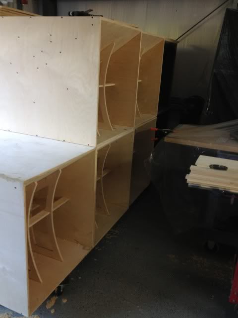

Sorry its been so quiet guys.. I was at a little stand still with the club's parking. Meanwhile I banged out the another 4 T60's.. I cant wait to hear all 8 of them
I'm waiting for a my Driverack to come back from repair or a my new one I got for a back up to arrive and I can start playing again! Here's a shot of the Tubas stacking up!
