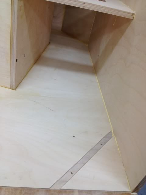

Here is pick of the glue oozing out of the dado.. I basically fill the whole dado with glue to make sure this sucker is sealed.. I also silicone the joints in the sub chamber since there is a lot of pressure in there..

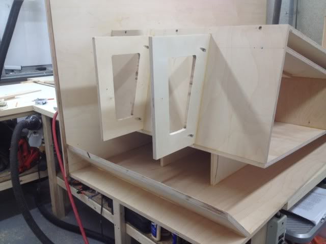

I worked on it for a few hours today and got some more assembly and jigs done..

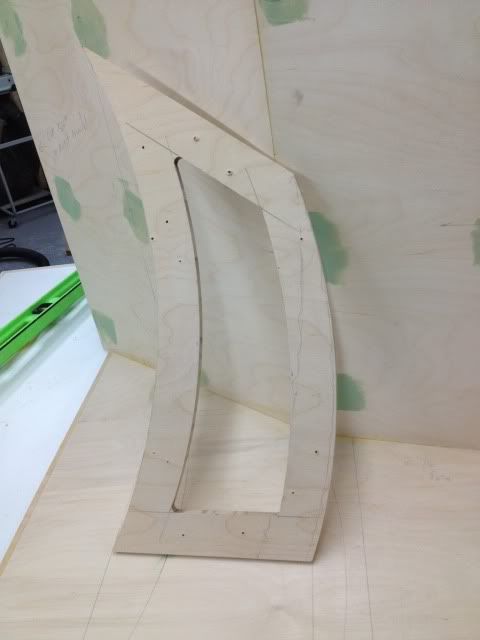

Im also throwing around the idea of curving all the braces in the mouth.. heres the first jig/pattern I made..

Nice work on the curved braces! Nice shop. Nice jigs. One heck of a journey!

That glue looks suspicously like yellow wood glue, which is not recommended. You seem to be quite a good craftsman and that glue may work fine but pl adhesive is preferred for a reason. Great job and those jjigs are going to be invaluable.

Posts: 900
Location: Kankakee, IL
#39 Post by Rich4349 »
Yeah, I noticed the same thing.
1st thought: "Wow, those joints look great!"
2nd thought:"Ohhh...that ain't PL."
Sure, wood glue will physically hold the panels, but it shrinks as it dries, as compared to PL, that expands, FILLING IN unseen / UNSEEABLE air gaps, which will spoil performance (at the minimum), ruin drivers (worse), and or waste your time you invested in the build. You will likely only end up cutting 1 to 16 of them open to locate and repair any number of leaks later on.

+1 use PL.. Regular wood glue definately won't cut it and sealing the joints with silicone is major ekstra work when PL can do it alone..

Michael Ewald Hansen wrote:+1 use PL.. Regular wood glue definately won't cut it and sealing the joints with silicone is major ekstra work when PL can do it alone..
+1. If wood glue was OK it would say so in the plans. But it says Do not use traditional woodworking glue , and there's a reason for that. One leak can screw up the entire build.
#42 Post by LelandCrooks »
It's also not as strong as PL. Even if you're using one the high end yellows. PL has some flex before the joint breaks, the aliphatics do not. Both will destroy the ply, but it takes more pressure for the PL to give,and when it does it's a gradual failure rather than a crack. Plus it fills the gaps. In tops they won't kill anything but performance, in subs you'll lose a driver if it's in the wrong place.

Wow; I was so busy staring at the quality of the cuts that I didnt' notice the yellow glue. :slap: My friend, you need to use PL for all the reasons mentioned. Save yourself time, money and heartache later and build w/PL now.

Ok fellas PL it is! Ill use it for the rest of this build but this T60 is slated for shop duty only.. I promised the guys they can keep this one. I can honestly say I've built 100s speakers over the last 20 years using glue and silicone w great success but I'm always willing to try something new. Now I just gotta find a way to keep the joints clean in the mouth. I'm kinda a neat freek :)

#45 Post by DJPhatman »
hifibob wrote:Ok fellas PL it is! Ill use it for the rest of this build but this T60 is slated for shop duty only.. I promised the guys they can keep this one. I can honestly say I've built 100s speakers over the last 20 years using glue and silicone w great success but I'm always willing to try something new. Now I just gotta find a way to keep the joints clean in the mouth. I'm kinda a neat freek :)
Thanks for the kind words guys...
Read my signature. Air tight is PARAMOUNT in the construction of the subs. How many previous builds have you done with 1/2" material and braces? Everything that is written in your plans is there for good reason. To get advertised results you must follow the plans.
As far as keeping the joints clean, be very very patient. Wait for the PL to FULLY cure and expand. Once it is fully cured it is very easy to remove the excess with a sharp chisel. You can help it to cure by moistening the glue joint surfaces, then apply a 1/8-1/4" wide bead of PL. Compress the joint with screws, clamps or brads, to hold the joint until the PL cures in about 24 hours, depending on the temperature. If you can keep the temperature around 75 F (~24 C) this is ideal for the PL to cure.
