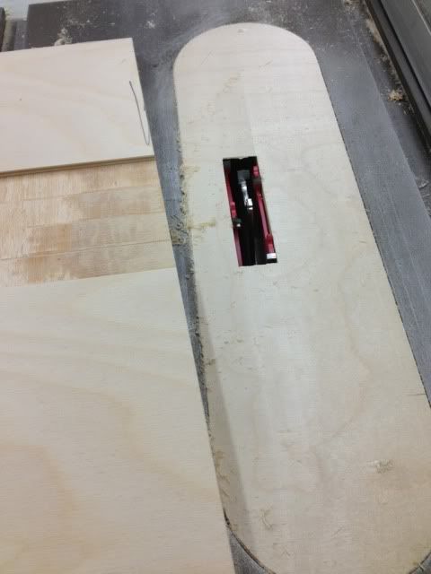

Today was a good day I got a bunch done.. Got all the sides dado's done and installed..

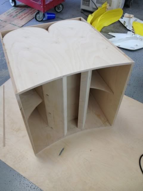

Trimmed everything up and decided to curve the face in instead of out.. For some reason Im wishing I did it the other way but its too late now :(

hifibob wrote:Image]
Cant figure out what I'm looking at here!! :ugeek:

Ian Westwood wrote: Cant figure out what I'm looking at here!! :ugeek:
It's the dado you need when the butt cheeks meet the side.
Or are you talking about the table saw insert for the dado blade?

Scott Brochu wrote:It's the dado you need when the butt cheeks meet the side.
Ahhhhhh. Right. I see it now.
Hey Bob, any chance I could see a more detailed picture of that dado blade set up when you can please?

hifibob wrote:For some reason Im wishing I did it the other way but its too late now :(
Yeah- not bad but ...it looked better in my head than it does in the picture. Sorry to have influenced that way...
Sure I have another one I can snap some pics of, but basically its a bunch of spacers and saw blades you can stack together to get a desired thickness. I use it so much that I leave it installed on its own saw since its a pain in the butt to take it on and off.
lol not your fault.. I'm going to try and work with it, I'm going to bend a steel grill to cover the tweeters maybe that will do the trick.. All else fails I could arch it the other way or cut it straight per the plans..

could always glue the piece you cut out back in lol.

sine143 wrote:could always glue the piece you cut out back in lol.
lol.. I could try and do one of them patch thingies Ian did.. you cant even tell!!
