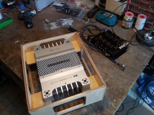

This is it:
The X-over as well as the level control and A/B switch will be mounted opposite to the amp. inside the other half of the rack.

OK, I'm almost there. The amp. rack is ready and tested:
I hope to manage tommorow the comparison test in the car. On Friday I am going to demo the AT at a meeting of a local car audio group.
It will be interesting to see their reaction to this 8" + 150w amp. setup...
