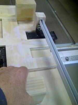

jswingchun wrote:I made one for my EZ track saw. You do have to flip the piezos upside down.
Isn't there a danger of all the swarf falling into the element by going upside down?

Easily solved by using a healthy thick wedge of masking tape I'd imagine. That's what I'd do at least if that was the only way of cutting them.

Harley wrote:Isn't there a danger of all the swarf falling into the element by going upside down?
The rail is over the top of the portion of the tweeter with the element. Only the part being cut off is visible. The swarf flies safely into the dust collector and around the garage.

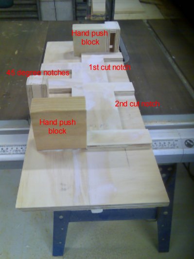

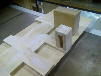

I think that you may be fortunate that I had copied the whole post when Harley first submitted it. i had to do some copying and pasting, saving images and loading images in order for the original post to appear as it was.
First page
OK, one side does the side trimming and has two set distances - one for the first trim and one for the second.
The other side of the jig when rotated 180 degrees, does the 45 degree cut - again two trim WIDTH sets,

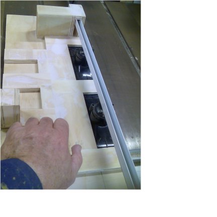

This shows the first side trim you make

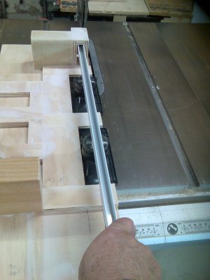

Once you've done the first, load that into the second position for the second trim ( if required ) and put a new piezo in the first position - then cut the two at a time.
Harley #6.jpg (20 KiB) Viewed 16358 times
Here's the 45 degree cut once you've turned the jig through 180 degrees. Note two positions to accomodate the two different width trims.
I had to shim the edges up until I got them right which took about 5 piezos to bin, then the result is perfect every-time and very very quick.
The little block houses to hold the aluminium locking bar again had to be shimmed in height until they were perfect. For the side trims, it has to be exact so you can pressurise each piezo when doing two at a time.
The push blocks are mandatory to keep your mits away from the saw blade.
