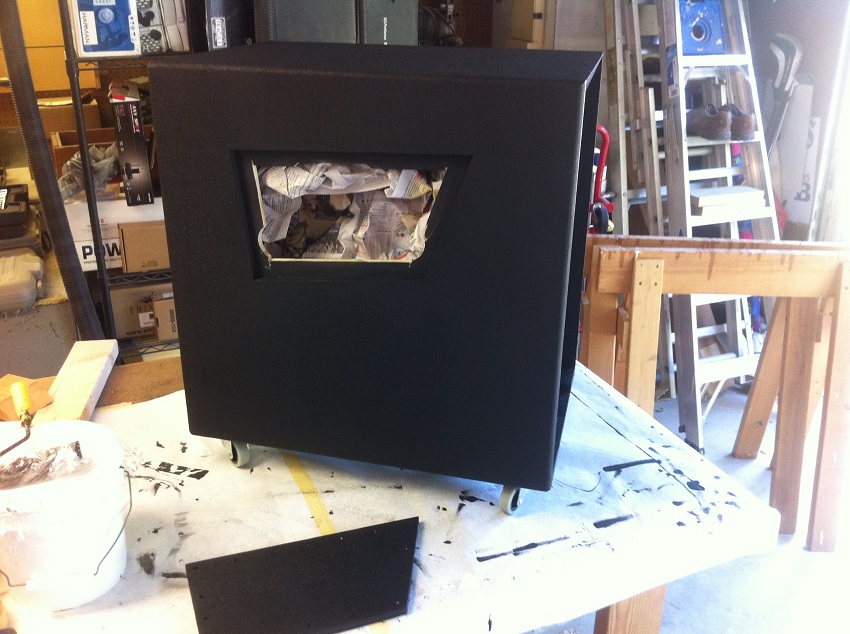

I didn't have any trouble mounting the driver with only 1 access panel. Just get the easy ones started first then the others should be lined up.
- Posts: 8664
Re: T24 Build
The crossover mounted in there would have made it tougher....and there's no way I could have mounted the crossover after the speaker was in.johns811 wrote:I didn't have any trouble mounting the driver with only 1 access panel. Just get the easy ones started first then the others should be lined up.
So, I just stuck the speaker in before buttoning it up. It's worked fine. Of course, the 3010FL has only 4 mounting holes, so that makes it easier too. I couldn't imagine trying to get those back ones started and cranked down with 8 holes.
Re: T24 Build
It wasn't that difficult, my driver had 8 holes, I used hex head bolts. I was able to start with fingers then get a socket on it and tighten it up.
- Posts: 8664
Re: T24 Build
That's what I would have done, but it was going to be a tight fit. I tested it and I could have done it, but it would been hard to get much torque inside there.johns811 wrote:It wasn't that difficult, my driver had 8 holes, I used hex head bolts. I was able to start with fingers then get a socket on it and tighten it up.
Anyway, I can get the driver out if I need to, but it was way easier putting it in first. Doubly true with the crossover components....the BB is really hard to start a screw in by hand in a cramped space with a stubby screwdriver. Glad I could get in from the other side to get some leverage.

We did the same thing with our T30's, Bruce; single access cover and install driver before 2nd side goes on. Worked a treat, may be a little trickier to remove/reinstall but we figured we'd cross that bridge if we got to it
possibly more room to work with than T24 with crossover though like you say...

I used a hurricane style nut, so it was very easy to snug up once I got it threaded. I had mounted it previously to make sure everything was lined up.
- Posts: 8664
Re: T24 Build
My T39s all have hurricane nuts, but this one has lag screws.johns811 wrote:I used a hurricane style nut, so it was very easy to snug up once I got it threaded. I had mounted it previously to make sure everything was lined up.

I recently had to replace (well not really) a driver in one of my DR 250's,one of the first ones i built before i seen how Harley cut recesses in the braces to access driver bolts on the side,i couldnt imagine trying to do it with just 1 access panel.

Put duratex on the bottom first, then attached the wheels.....much easier putting on the two coats of duratex on the rest of the cab when I could just spin it around on the wheels.
Gonna' let it dry, then probably add the corners and jack plate this afternoon.
Should be making noise shortly thereafter....

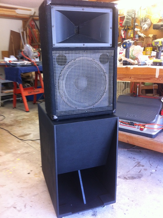

It's done except for the chevron corners....shoulda' remembered to buy some of the little black screws from Leland. I have some silver ones....but, they don't look as good....finding 'em locally is impossible. So, I need to order some.
Anyway, it works.....looks pretty good too all stacked up...

Jamb the screws into some cardboard and spray-paint them. Make as many as you want/need. Oh, and any colour as well.It's done except for the chevron corners....shoulda' remembered to buy some of the little black screws from Leland. I have some silver ones....but, they don't look as good....finding 'em locally is impossible. So, I need to order some.
- Posts: 8664
Re: T24 Build
Tom Smit wrote:Jamb the screws into some cardboard and spray-paint them. Make as many as you want/need. Oh, and any colour as well.It's done except for the chevron corners....shoulda' remembered to buy some of the little black screws from Leland. I have some silver ones....but, they don't look as good....finding 'em locally is impossible. So, I need to order some.
I care enough to buy new screws....I don't care enough to paint 'em.
