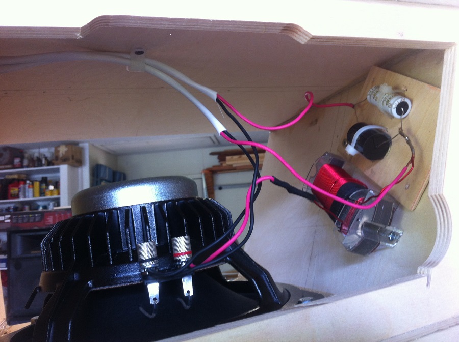

Ok, now I need some help....
Got the crossover wired inside the cab. Hooked everything up just to test and ran some music through it. Speaker was just sitting in the sub and it's still missing one side.....I noticed that I was hearing a lot of higher end material out of the sub driver.
So, I unplugged the top box to check it out.....ran a 1k test tone through it and was hearing it....ran a 4k tone through it....hearing that too. When I plugged the top box back in, of course that box reproduced both tones much louder.
I've always run my subs through a 24db/octave slope crossover, so I've never experienced hearing the higher stuff though a sub. The T24 passive crossover is as per the plans. The plans say the high pass is 6db/octave slope, but it doesn't address the slope on the low pass.
Does it have a really low db/octave slope on the low pass? Is that why I'm hearing 1k and 4 k out of it?
I don't see how it could be wired wrong.....it's very simple. Just put the inductor in series with the driver....not much to screw up there.
Bill or Leland.....any ideas? Should it be like this since it's passive?
Need to figure it out before I button it up.

Re: T24 Build
Even if you are getting hi end frequencies through, will they not be filtered out by the horn?
Re: T24 Build
It's a first order 6db.  You will stilll hear higher frequencies , albeit at lower and lower volumes.  The xover point is 150hz iirc, so 1k will only be about 4-5 db down.

Re: T24 Build
Thanks Leland. I kinda' figured that was the case. So, I guess I'm gonna' be pulling a wide swath of EQ centered around 150 to clean out the mud in that area....with two sources playing there.LelandCrooks wrote:It's a first order 6db. You will stilll hear higher frequencies , albeit at lower and lower volumes. The xover point is 150hz iirc, so 1k will only be about 4-5 db down.

Re: T24 Build
Ok....so, what's the reasoning in using such a shallow slope for the crossover? I'm sure it would require more components to go steeper....what would that look like?LelandCrooks wrote:It's a first order 6db. You will stilll hear higher frequencies , albeit at lower and lower volumes. The xover point is 150hz iirc, so 1k will only be about 4-5 db down.

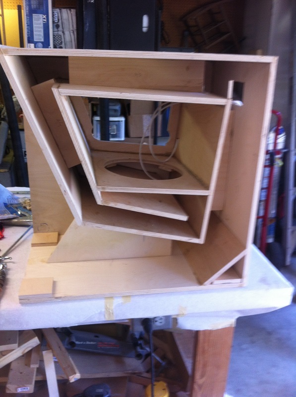

Re: T24 Build
I wonder if surgeons feel a little reluctant about closing after working on somebody's plumbing......I mean, why are we closing up the cool stuff where nobody can see it?

Re: T24 Build
You would need 2 of these:Bruce Weldy wrote:I'm sure it would require more components to go steeper....what would that look like?
and then 2 of these:
that's over $130 for a 12 dB/octave x-over @ 120hz.

Re: T24 Build
Ok, I guess the crossover does indeed fit in the driver chamber....but it was way easier to get it in before putting on the other side.

 - Posts: 28982
Re: T24 Build
$$$$$. A high quality 18dB 2-way passive crossover at 150Hz or lower would cost more than an active crossover. That's why they're not used. The 6dB crossover in the plans is a better than nothing option.Bruce Weldy wrote: Ok....so, what's the reasoning in using such a shallow slope for the crossover? I'm sure it would require more components to go steeper....what would that look like?
The horn filters high frequencies. It neither knows nor cares if they're fundamentals or harmonics.Those with more knowledge can correct me if I'm wrong, but the horn doesn't filter high frequencies per se, but rather harmonics of the root. In this case, it's the root that's coming through, not harmonics.

Re: T24 Build
Then I learned something. So, I'm assuming that the 4k I heard coming out of the speaker itself will be greatly attenuated when coming out of the horn?Bill Fitzmaurice wrote:The horn filters high frequencies. It neither knows nor cares if they're fundamentals or harmonics.
