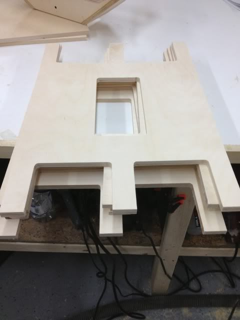

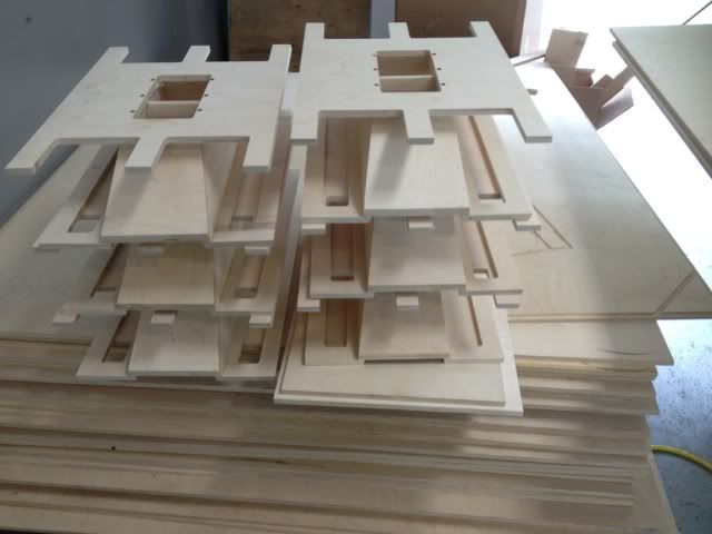

So today I realized that I probably should have built one first before doing 6 at a time.. When I make a mistake its x6
Any way made this jig to simplify the woofer baffle..
and here's all six of them, well 12 of them if you count the ones i screwed up on..
errr human error often intervenes huh.
The "wasted" ply is probably not a frustrating as the wasted time.

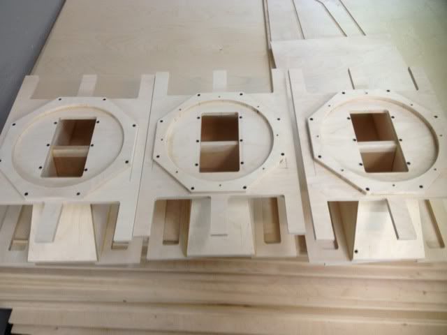

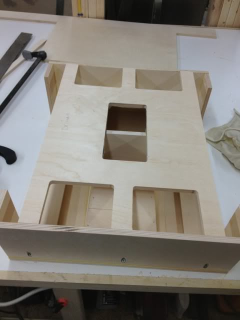

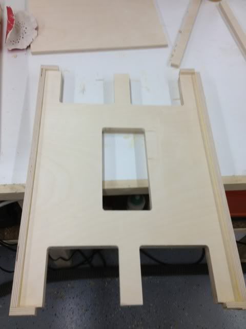

Well not much goin on but I had a few hours today to get some stuff done,,
Made this jig up to speed up attaching speaker baffle to horn/throat, worked like a charm and made for quick assembly.
10 minutes later..

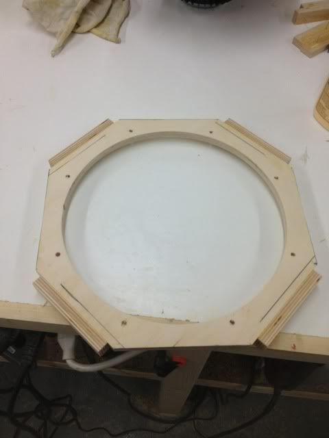

oh and this guy to whip up woofer spacers..
10 minutes later..

That's some mighty nice,craftsmanship
you make building these things look easy. I really like the jigs you're constructing for assembly!
Thanks Disco! The time is definitely well spent building them.. I can really bang these things out now...Disco-inferno wrote:That's some mighty nice,craftsmanshipyou make building these things look easy. I really like the jigs you're constructing for assembly!

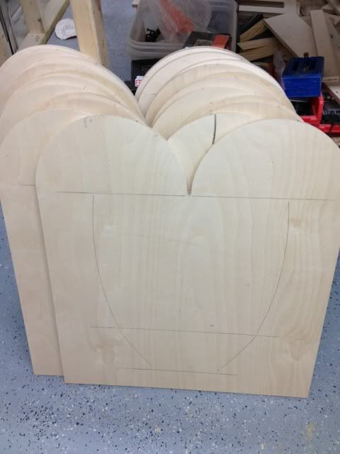

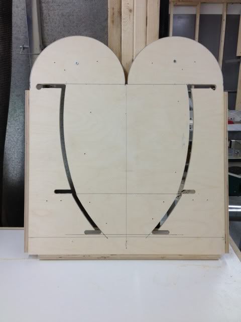

This one seems to be the most helpful so far.. Cuts the top and bottom panels but also makes drawing the layout lines without all that measuring and compass work.
Took me about 20 minutes to do all 12 of these once jig was finished.
