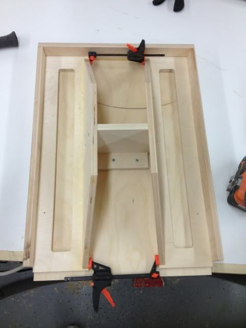

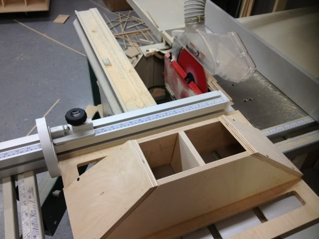

Ya thanks for reminding me lol.. I'm actually looking forward to tackling this build, I'll def take my time and find cool methods to help me simplify it. Meanwhile I got all 6 horn/throat assemblies done.. I made this jig up to hold everything square while I assemble them..Grant Bunter wrote:I'll +1 biggerigger's comment.hifibob wrote:These are def a tedious speaker to build. So far Ive only only gotten to the horn/throat assembly but for six cabs.. I keep peaking deeper into the plans just to scare myself

Cutting them to size..
all ready for the next step!
Jerk......but really, that's incredible. Those look clean.
thank you my friendncgrove wrote:Jerk......but really, that's incredible. Those look clean.

Wow. Awesome work Bob. You reversed the clamps!! Simple and ingenious! That never occurred to me!

Thanks Ian.. Ya I picked that up from my dad one day..Ian Westwood wrote:Wow. Awesome work Bob. You reversed the clamps!! Simple and ingenious! That never occurred to me!

hifibob wrote:I made this jig up to hold everything square while I assemble them..
That jig is very familiar. Almost the same as what Harley and I came up with.
All I need to do now is break into your shop tonight a steal the rest of jigsLelandCrooks wrote:That jig is very familiar. Almost the same as what Harley and I came up with.
