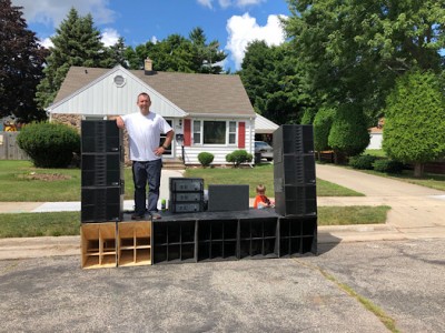

Ok fellas, I had a guy come over this morning for a demo, and we got the cops called on us!!! Most epic!
The cops were totally cool with it all, I should of asked for a picture with them. Oh well maybe next time
Me and my little helper, in the back!

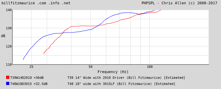

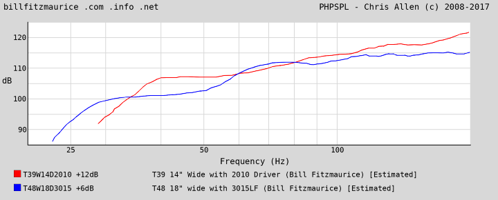

Re: Scaling way back! Lots of questions
Four 10" loaded (Not the 3010LF, but response should be relatively similar) T39 slims compared to 2 18" T48's @ 2.83v.
(Edit: Changed to 18" T48's after re-reading the thread)
Adding 24dB to the T39 trace for max output, 26.5dB to the T48 for it's max
To my eye, looks like the T39 slim is the better option.
