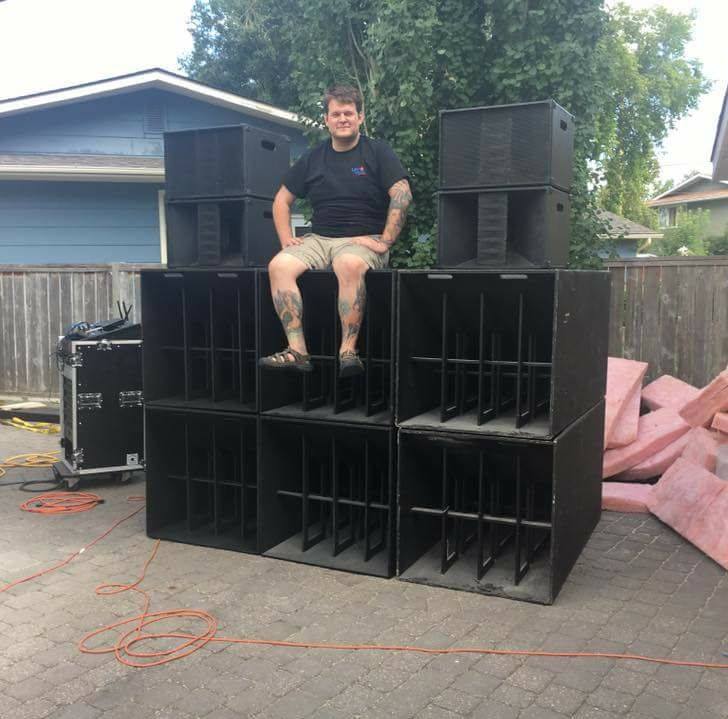

Hi, my husband and I are working on developing a business which involves dance music and music to lounge and relax to. We plan to reach out to our friends for support and good times. We have invested a lot in the music already and Now, our next step is to equip ourselves with the best audio equipment.
After doing a thorough search online and seeing what's out there among company manufactured subwoofers, Richard has found that Mr. Fitzmaurice's Tuba 60's with the Eminence Lab 15 have extend further down in pitch than any other he's seen online. They are the more cost effective and it will be personally more rewarding to build them than to have them handed over to us by a retailer.
Our objective to build 3 Tuba 60's, one for indoors, two for outdoors which will be playing at the same stage at the same time and to build four DR 250's two for indoors, two for outdoors, with Deltalite-II-2510 woofers and 20 Goldwood-GT-1010 piezos in each box.
We would like to know what are the best amps for the indoor and outdoor combos. Maybe two amps are needed for each? Richard is confused because he doesn't know if 6 (Lab 15) and 8 ohm (Deltalite-II-2510 and Goldwood-GT-1010) speakers/tweeters can be connected most ideally on one amp.

Hi Nancy (and Richard),
Welcome to the forum
"Dance music" is too generic, one of Bill's quotes is
The T60 is also quite large, think refrigerator large.
When you say 'dance music", exactly what do you mean?
Also, do you happen to know what low content (ie a value in Hz) you require to be reproduced by subs?
It's important to help you sort out what you really need when it comes to building.
Something that does need to be factored into budget is DSP or speaker management. This investment is mandatory, to protect your speakers.
It can be purchased as rack units like the DBX driverack series, or some amplifiers have it as well...

What kind of dance music, top40 or EDM? How many people do you expect to provide for and how loud do you intend to go? Dance club middle of dance floor loud or something a little tamer?Nancy B wrote: ↑Mon Nov 05, 2018 7:25 pm Hi, my husband and I are working on developing a business which involves dance music and music to lounge and relax to. We plan to reach out to our friends for support and good times. We have invested a lot in the music already and Now, our next step is to equip ourselves with the best audio equipment.
Refer to the above question. Do you really need 25hz output that the T60 can output? Horns get exponentially bigger the lower you want to go. A 27" wide T60 with a lab15 is the size of a small fridge. Do you have the packspace and more importantly the muscle to move them around? My 29" dual lab12 T60's takes 3 strong people to lift them on a truck. Did I say they were big?Nancy B wrote: ↑Mon Nov 05, 2018 7:25 pm After doing a thorough search online and seeing what's out there among company manufactured subwoofers, Richard has found that Mr. Fitzmaurice's Tuba 60's with the Eminence Lab 15 have extend further down in pitch than any other he's seen online. They are the more cost effective and it will be personally more rewarding to build them than to have them handed over to us by a retailer.
I can count on one hand how many times I have heard EDM DJ's tracks drop down to 25hz (and needed that for the (track). That is over 180 EDM shows with about 4 DJ's per show. Even on those handfull of tracks you really don't hear 25hz, it just vibrates the building and gives you an eerie sense. Of the over 300 top40 dance music nights they have done, not once has 25hz been necessary. I left mine at the venue they were in when I left and am now going to build a pack of T45's to go mobile with. T45's go down to 30hz and are much easier to move around and take up way less pack space. 30hz is more than low enough for even 99% of EDM. I would strongly consider your needs/ability to move/store/chiropractor costs, etc before you decide on lab15 T60's. For a permanent install or a steady gig where you can store them between shows then by all means use them, but to move around regularly, I'd reconsider.
DR250's go really loud and are the cleanest sounding box I have ever heard. To match up with the tops for most styles of music a 1:1 top to sub ratio is advised indoors, 1:2 ratio outdoors. Even with the higher output lab15 T60, the DR's would still outrun your proposed ratios, 2 of my DR250's can outrun 2 double 18's with a 3000w amp on them. For EDM I would double the sub to top ratio, 4 tuba subs for 2 tops indoors, 8 subs for 2 tops outdoors. Of course if your volume levels are modest you might be okay with your proposal.Nancy B wrote: ↑Mon Nov 05, 2018 7:25 pmOur objective to build 3 Tuba 60's, one for indoors, two for outdoors which will be playing at the same stage at the same time and to build four DR 250's two for indoors, two for outdoors, with Deltalite-II-2510 woofers and 20 Goldwood-GT-1010 piezos in each box.
If you run mono you can get away with only 1 amp. Subs on one channel, tops on the other. As long as you don't go below the amps minimum rated impedance you are okay. The channels are independent so different ohm loads on each channel is okay as long as each channel doesn't go below minimum. 2 8ohm cabs on one channel is now 4ohms, 4 8ohm cabs on one channel is now 2ohms. Not all amps can handle 2ohm loads and is not ideal for the ones that can.Nancy B wrote: ↑Mon Nov 05, 2018 7:25 pmWe would like to know what are the best amps for the indoor and outdoor combos. Maybe two amps are needed for each? Richard is confused because he doesn't know if 6 (Lab 15) and 8 ohm (Deltalite-II-2510 and Goldwood-GT-1010) speakers/tweeters can be connected most ideally on one amp.
How mission critical is your show? Running 1 amp doesn't give you any insurance if you lose a channel or the whole amp. With 2 amps you can run stereo on the tops, split the loads on the subs and if anything goes wrong you can quickly patch everything into the working channels and continue with the show. If you are doing this for fun, start with 1 amp and add a spare later. If you are getting paid by clients and do this often, you will run into this problem, usually it is not even the amp but a bad cable somewhere. Where? you don't have time to find out, you just patch into the working channels and being able to quickly recover saves the day.
That used to be the case back in the day that with crown you got good sound quality and reliability. Everybody else has now caught up (or surpassed) to the point where amps are now commodity items. Well all the name brand ones anyways. The biggest thing nowadays that separates them is the DSP feature set, ability to handle low (2ohm) loads or not and ability to handle sketchy power or not. Reliability is about the same on all of them, you can get a dud from any manufacturer about equally, that's what warranty is for and they all sound the same.Nancy B wrote: ↑Mon Nov 05, 2018 7:25 pmAll we know, and this is old news to him, and he doesn't know if this current, is that Crown manufactures the best amps. Is this still true? Saving so much because of the speaker components, we won't mind to splurge for the best! We'll probably have the same balance, or still have less cost, then if we were to by manufactured audio equipment.
Look into some other manufactures as well. Crown, Crest prolite, QSC, Peavy IPR2, Behringer. You can even make your cabs self powered viewtopic.php?f=32&t=25068
As a fellow Canadian I appreciate the loyalty to Canadian stores but that is the expensive way to buy some (not all) equipment. Amps are much cheaper ordering from US sites like BHphoto, sweetwater, musicians friend, ebay, etc.Nancy B wrote: ↑Mon Nov 05, 2018 7:25 pmWe would like to buy a Canadian store, so here are our options. There are two stores to consider:
https://www.long-mcquade.com/department ... sovers.htm
https://www.avshop.ca/sound-amp-pa-audio/amps (this one seems "better/more options" says Richard.)
You will need a decent DSP to run these speakers. One that has a good limiter, xover, and decent EQ. The behringer 2496, dbx driverack series, or ashley protea are the standard outboard goto ones. Nowadays many amps have these features built in and that can save some money and weight and space in your rack. Some have more features than others. For example, the behringer amps have the most comprehensive DSP's built in but the amps can only handle 4ohm loads minimum and really don't like being run off a generator if that comes into play. The crest and peavy amps can handle 2ohm loads no problem but have very limited onboard EQ.
Choosing whether to go with amps with DSP or to use an outboard DSP or which amp or model to buy, or to make your boxes self powered with the amp in the link I shared above is worthy of its own thread depending on your needs, expansion plans if any, budget, etc.
Other audio equipment you will need are speaker stands, xlr cables, speaker cables, rack mounted power bar, a rackcase for amps/dsp/power distribution, microphone for announcements (with on/off switch)

Well, if you don't have to lug them around much then build the T60's ! Some of us have to lug this stuff around from gig to gig and load it in and out on a truck 3 times a week so we were sharing some advice our backs were giving us .
Some other tidbits, those driver specifications are measured infinite baffle, meaning they cut a hole in a wall, mount the driver and measure it. Once you put that driver in a horn, everything changes. T60's go to 25hz , T45's go to 30 hz in groups of 4 or more.
For your indoor chill space something like the table tuba might be loud enough and take up less space and be easier to move around, ditto for the tops. The sla's or tlah's might be a better fit for in a house.
Powered boxes won't be less expensive than outboard amps, they are convenient for some applications but for yours, running power and signal to all the boxes would be a tangled mess. An amp rack would be the way to go.
As far as sound quality, these boxes, once you master tuning them are about as clean a sound as you can get. In fact, you probably won't hear the best of them off of iTunes. You really need uncompressed files to hear all the detail these things can do.

The master tuning them comes from the sound triangle. To get good sound you need all 3, room acoustics, great gear, and tuning. Just like a guitar. No matter the quality of gear you use, you have to spend some time fiddling the dials to get it right. No brand out there is plug and play excellence, to get the magic it takes a bit of time to learn how to tune it. Speaker placement, delay, EQ, spacing the speakers, etc is a learned skill that comes with experimenting. Anyone can learn it but like any other skill you have to work at it for a bit.
Most genres 2:1 outdoors is enough but for EDM, yes 3:1 if not 4:1 outdoors. That's for full on concert volume levels, for lower levels less would be fine. This is a buddy of mines outdoor system, 4 Otop 12's with 6 dual lab12 T60's. He uses this for EDM and is happy with the balance. Understand that this is for concert level sounds. For 250 people up close this will full on melt your face and turn your body to jello .
