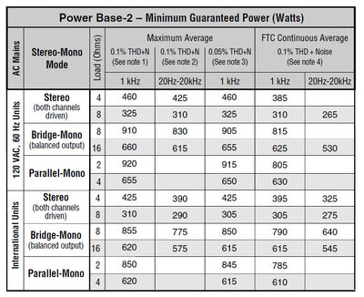

The Crown Powerbase 2 specs that I can find:
All specifications apply to units in Stereo mode with 8-ohm loads
and an input sensitivity of 26 dB unless otherwise specified.
Standard 1 kHz Power: refers to maximum average power in
watts at 1 kHz with 0.1% THD+noise.
Full Bandwidth Power: refers to maximum average power in
watts from 20 Hz to 20 kHz with 0.1% THD+noise.
120 VAC, 60 Hz Units: refers to amplifiers with dedicated transformers
for 120 VAC, 60 Hz power mains.
Performance:
Frequency Response: ±0.1 dB from 20 Hz to 20 kHz
at 1 watt.
Phase Response: ±10 degrees from 10 Hz to 20 kHz
at 1 watt.
Signal-to-Noise: A-weighted, better than 105 dB below
full bandwidth power. Better than 100 dB below full
bandwidth power from 20 Hz to 20 kHz.
Total Harmonic Distortion (THD): Less than 0.05%
at full bandwidth power from 20 Hz to 1 kHz increasing
linearly to 0.1% at 20 kHz.
Intermodulation Distortion (IMD): (60 Hz and 7 kHz
4:1) Less than 0.05% from less than 158 milliwatts to full
bandwidth power.
Damping Factor: Greater than 1,000 from 10 Hz to 400 Hz.
Cross Talk:
Greater than 90 dB below full bandwidth
power from 50 Hz to 2 kHz, rising linearly to
greater than 66 dB at 20 kHz.
Common Mode Regection: Better than 70 dB
below rated full bandwidth power from 20 Hz to 1 kHz
falling linearly to better than 50 dB at 20 kHz.
Controlled Slew Rate: Greater than 13 volts/ms.
Voltage Gain: 20:1 ±3% or 26 dB ±0.25 dB at the maximum
level setting (Input Sensitivity switch set to its 26
dB position).
Power Base-2 : 64:1 ±12% or 36.2 dB ±1 dB at 0.775
volt sensitivity; 35:1 ±12% or 31.0 dB ±1 dB at 1.4 volt
sensitivity.
Output Power: The following specifications are guaranteed
minimums for standard 1 kHz power. For more information,
see the power matrices in Figures 4.1 through 4.6
(maximum average power @ 0.1% THD + N).

Crown has always been good about their numbers. Why are you testing the output? You can take the stated wattage and plug it into a calculator to give you the voltage.
According to the manual, this amp puts out 325 watts at 8 ohms. That's 51 volts.
Turn everything off on your board relating to crossovers, limiters, feedback destroyer, or anything else. You want the pure signal with no processing. Use a mono out if there is one.
