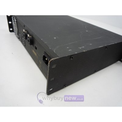

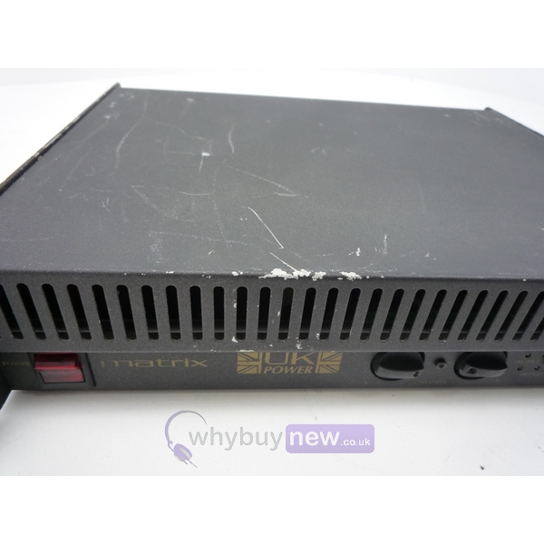

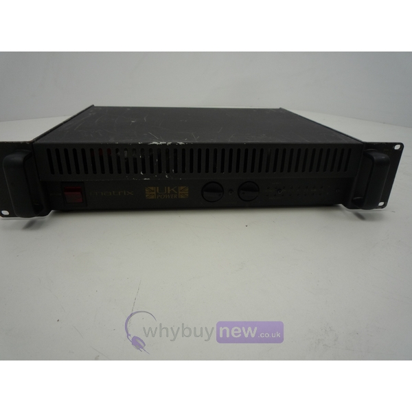

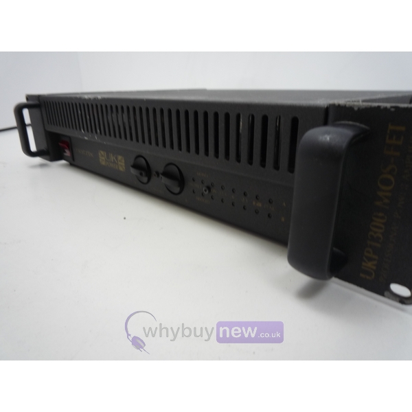

Some news to report:
Courtesy of a tip off from a DJ friend at work, I've found an amp. Not to everyone's taste, but it suits me; a Matrix UKP1300 from whybuynew.co.uk for £125. 390w@8ohm per channel, 650w@4ohm. British made. 17kg - will put in it's own case. I'm not too bothered about limiting (i.e. running up) to 50v (lab12) - there's naff all difference dB-wise between 40 or 45v, so in 4 ohm config., there could still be ample breathing space on power.
I may at some point try it on the tops, and use the Synq dig 1K0 (class D) on the subs - influenced by audiophile persuasions on class D's, but for now it'll do for subs.
Funny too, a friend originally recommended Matrix, as a nice amp to work on when they're broken!, for an amp for the Jacks, but I didn't want to stretch to their lowest rated class D offering, on money grounds. I figure he meant it was nice to work on the old iron ones anyway.
Pictures attached are from the whybuynew website.
Thanks for the help, chaps!
I'll tart up the scratches with some matt black and a fine brush.
