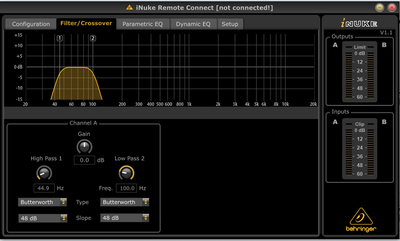

Take a look at my updated values (someone did a real resistive load test) and yes those were peak voltage ratings it seems.Gregory East wrote:The specsheet isn't too specific. Probably you can highpass and lowpass subs all hunky dory but it doesn't say. The 3000 would run 4 cabs, 880w @ 4 0hms, if it's RMS but it's probably some fake peak wattage, who knows? Not me and they aren't saying.
Behringer doesn't have much of a reputation around here so not much to go on. They haven't been taken up by BFM'ers in any numbers as far as I can tell.
As far as I can tell this software can do proper high and low pass (see picture)
