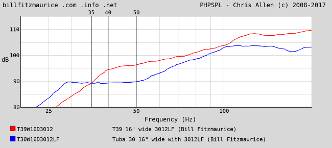

Then you should build T39. Loaded with the 3012LF, they beat the T45 in volume (SPL) but lose a few Hertz in extension. Since this sounds like it will be a performers stage, you do not want low extension. (T30 and T45 are basically identical in response)
You see that 6dB difference at 50Hz? that is equal to twice as many cabs. That mean 2 T39 are as loud as 4 T45 at 50Hz.
