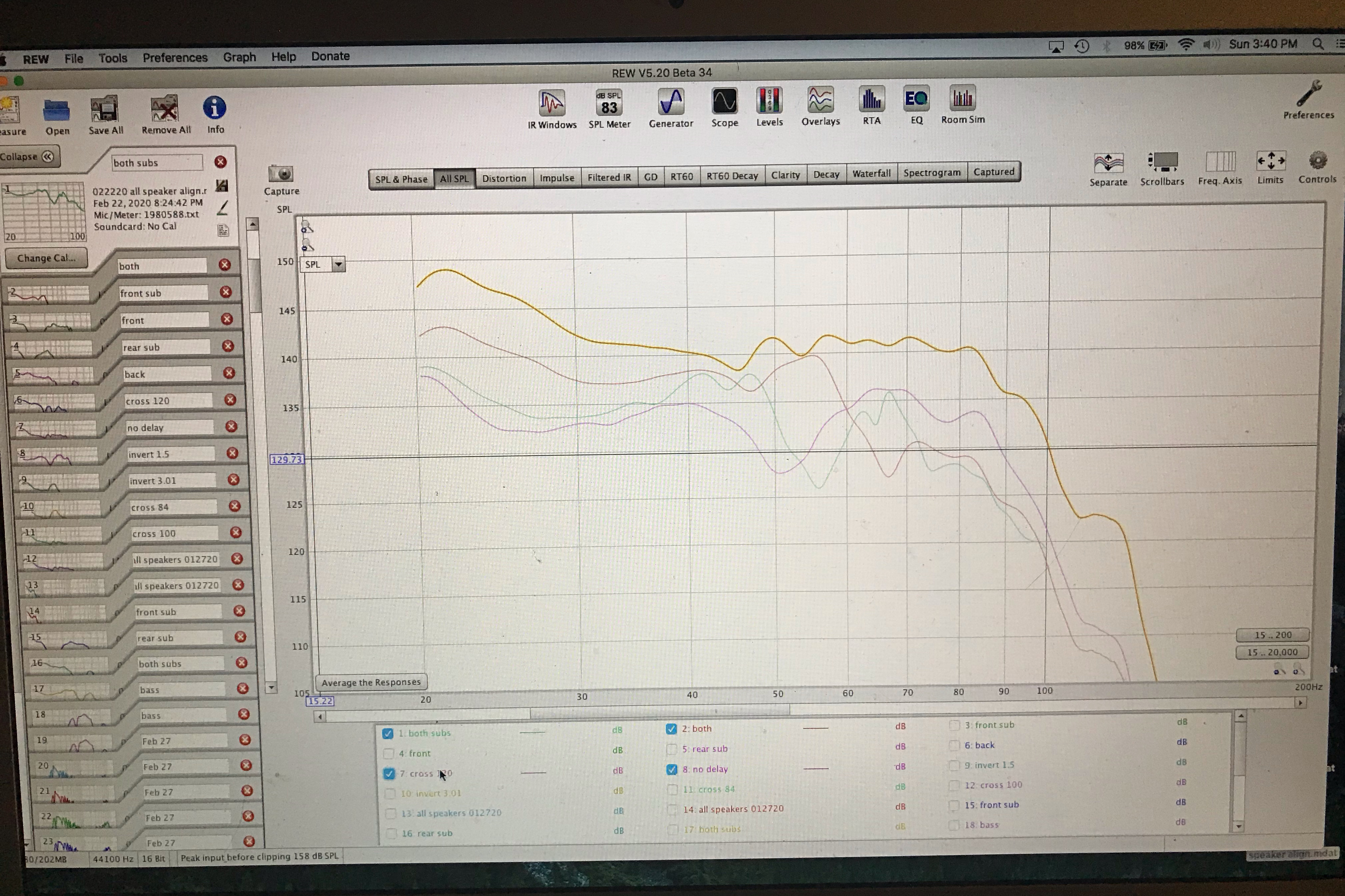

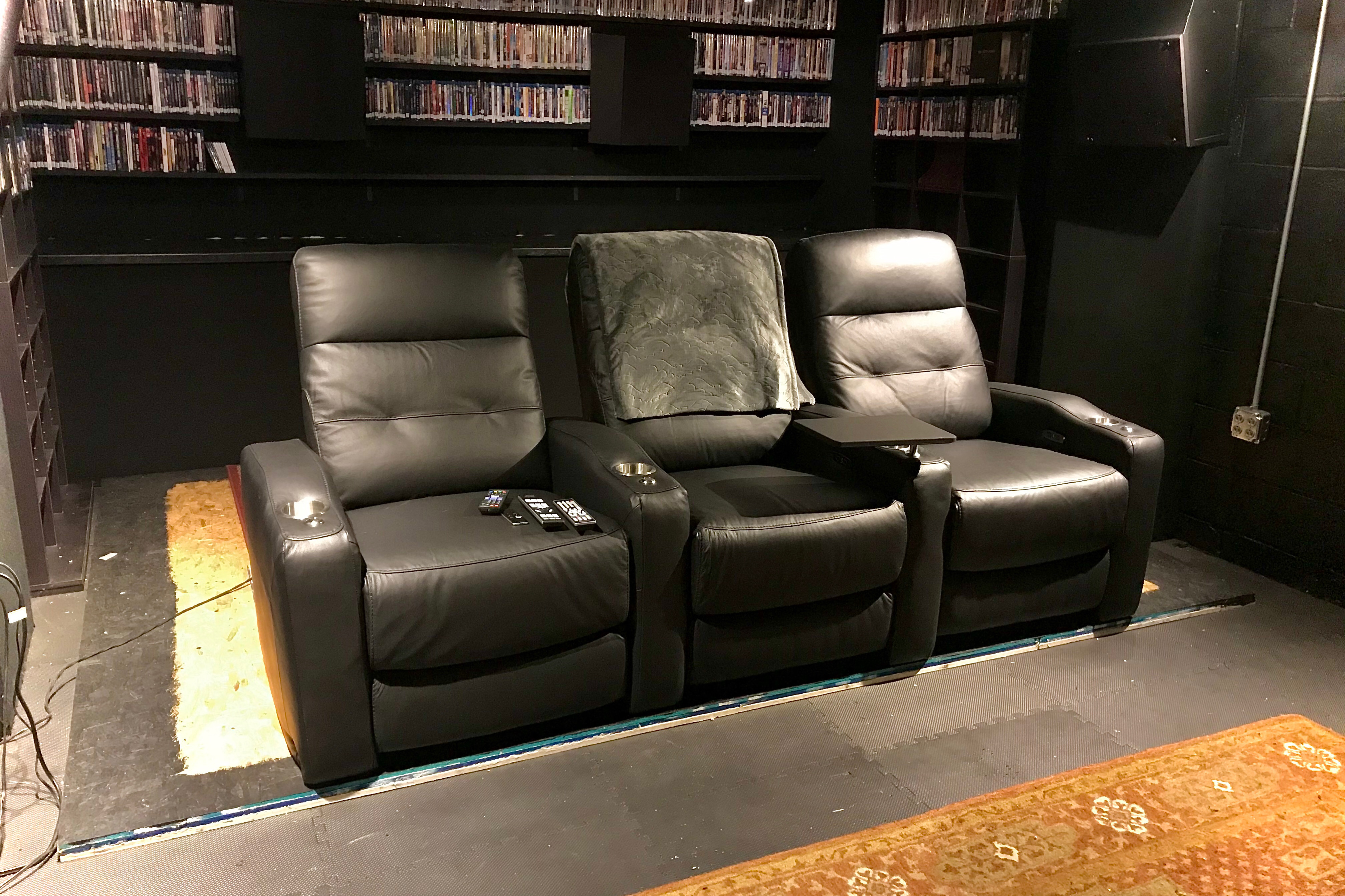

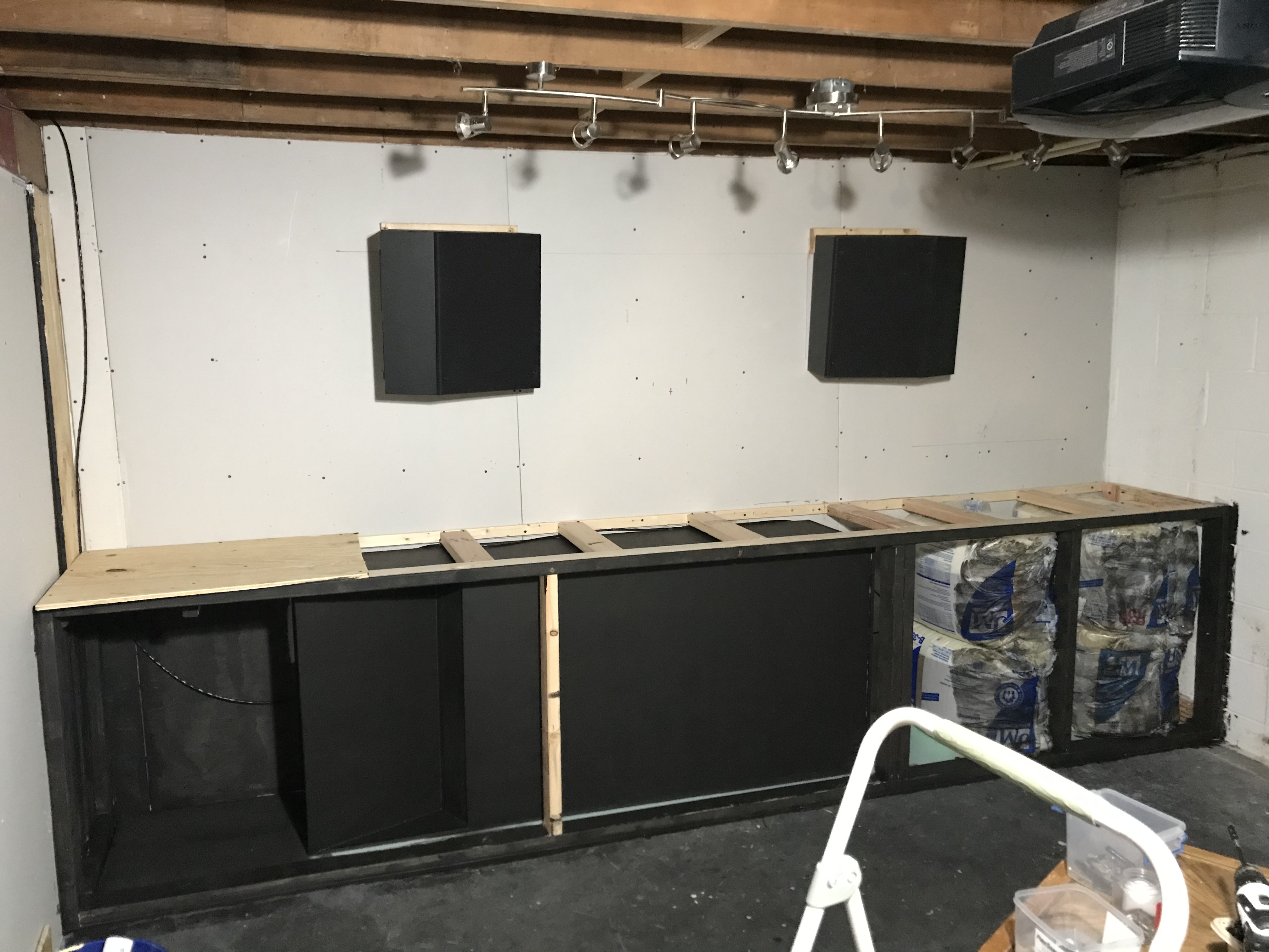

2 THTLP’s here... you can get them flat, and you can get them LOUD with 2. mine are 31” wide. Located at the front and rear of the room mouths about 20” away from the corner. My bass is even enough for my room. I’m using the RSS Dayton subs.
