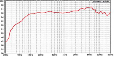

Bill, is there a published impedance/phase graph for the David with the recommended drivers? Also, the plans state that the mid-bass driver crosses at 3khz and needs to be 8-ohm 90db+. Assuming that there is no breakup how much of a rise is allowed above the crossover point? I am looking at a 8-ohm drivers with a FR like below:

I don't have graphs. Those drivers don't have a severe enough break up to be a concern, but crossing over low enough to avoid the break up mode is only half the reason for where the crossover point is. The other is off-axis response, which at even 3.5kHz is much better with a tweeter than with a four inch midbass.
